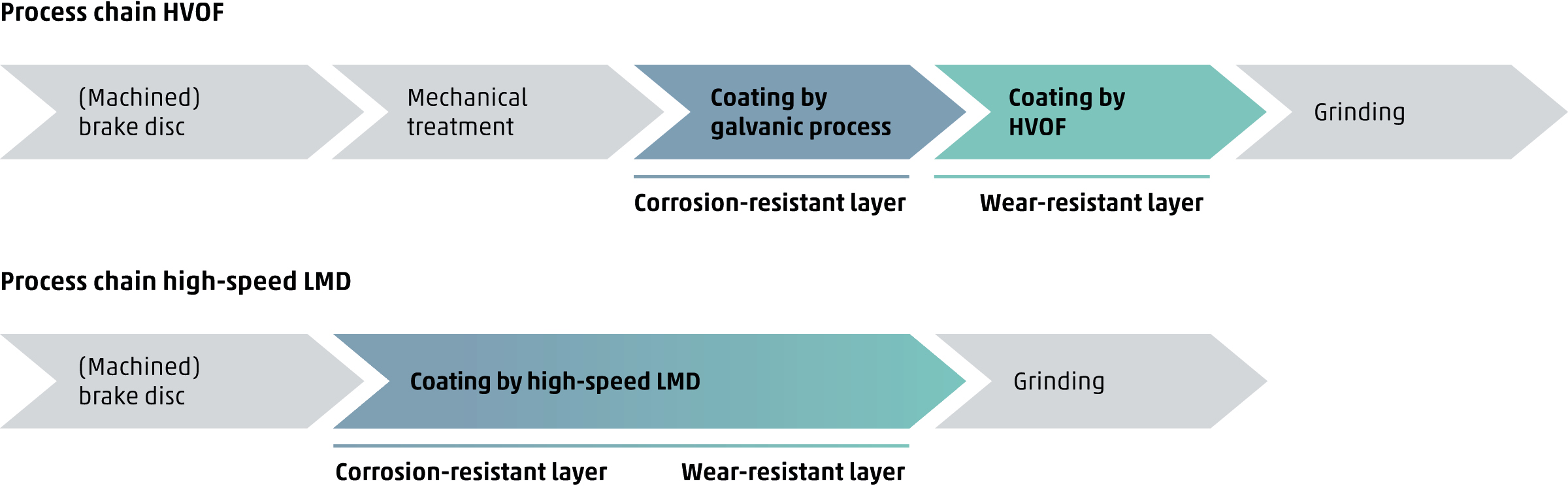

The process used in AM Coating also boasts advantages in comparison with thermal coating using high-velocity oxygen fuel (HVOF) spraying: Mechanical or thermal pre-treatment of the brake disks is dispensed, significantly shortening the process chain.
Further advantages compared with oxygen fuel spraying
  • Improved adhesion through molecular bonding
  • High degree of powder utilization
  • Thinner layers, down to tenths of a millimeter
  • Layers with different properties and thicknesses
  • Lower heat input and smaller heat-affected zone in the brake disk
