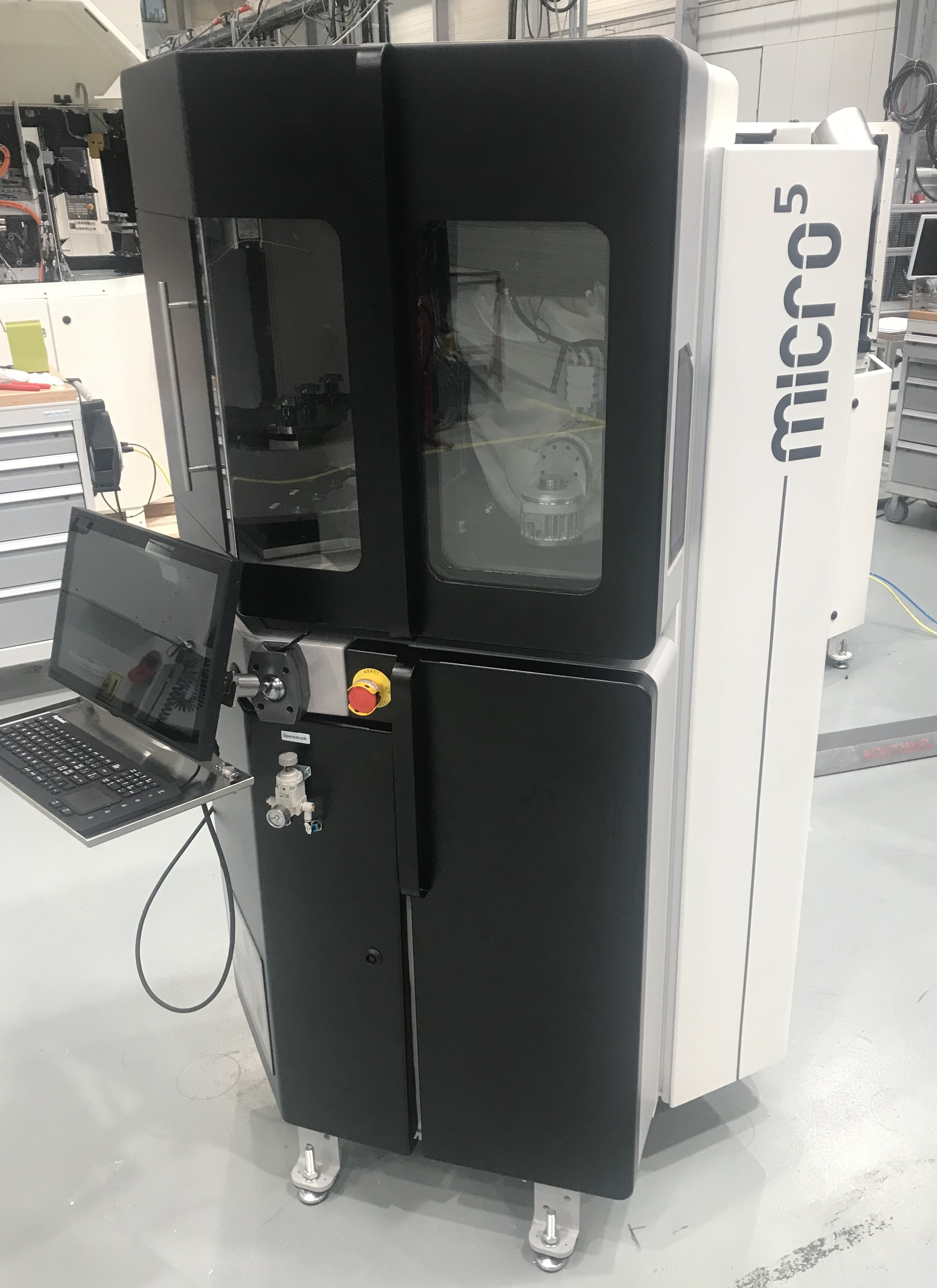

  • High-precision 5-axis machining
  • Ultra-compact machine
  • Machining cube max. side length 50 mm
  • High-static rigidity and repeat accuracy
  • Outstanding thermal stability
  • High-speed cutting
  • Low energy consumption < 500 W
  • Precious metal recovery
  • Palletizing with up to 6 pallets in the working area
  • Easy access for service and maintenance
  • Excellent view of the production process
  • Easily automated with Feed5
All the details at a glance
Technical data
Traverse paths X – Y – Z max.
78 – 56 – 50 mm
Spindle speed max.
60.000 rpm
Rapid feed X – Y – Z max.
30 – 30 – 30 m/min
Number of tools max.
3x8
Tool taper
HSK-EZ15
Control
Beckhoff CX2040
Existing special equipment
  • Integrated scara robot
  • Capacity: 6 palets Y32 (standard)
  • Tool vibration monitoring IFM
  • Clamping force regulation: by air pressure
  • single spindle
