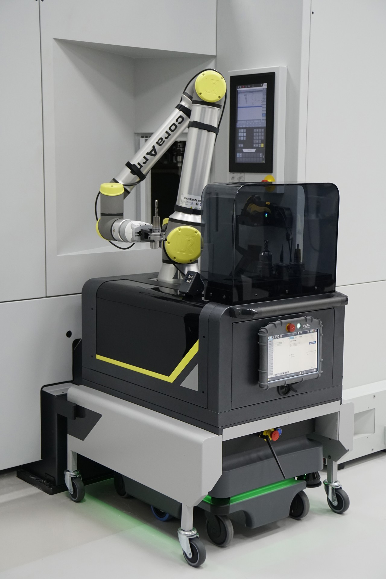

Smart solution, part 3: Automated tool handling with »cora«
When working with difficult-to-machine materials, such as Inconel or titanium, the tools need to be changed in a quick rhythm. Frequently changing order sequences also require correspondingly frequent set-up processes. This takes up work and machining time – just a few minutes each, but these add up over time and across all machinery. With »cora«, the cooperative robot assistant from ZOLLER, in combination with the CHIRON Group machining centers, potential for rationalization can be exploited and clear gains in efficiency can be achieved.
Benefits:
  • Save time thanks to automated tool handling on the setting device
  • Optimized production thanks to automated tool logistics
  • Continuous data transfer for maximum security
  • Data and stock transparency
  • Avoid tool-related spindle downtime
  • Highly productive even with small tool magazines
