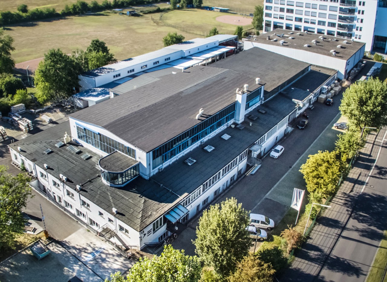

 The AMAG components site in Karlsruhe   Photo: AMAG components

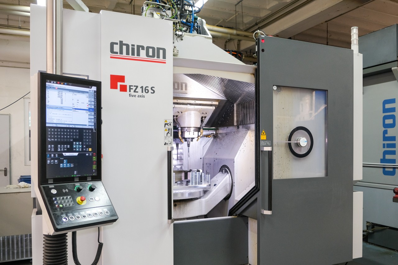

FZ 16 S five axis for AMAG components with HSK-A100
The CHIRON Group was also one of the candidates in the selection process for a new titanium machining center in 2018. The concept of the FZ 16 S five axis, which was installed later that year, »was a good fit for the requirements,« explains Markus Löhe, Key Account Manager for Aerospace. »Our new machining center also won the company over when it came to precision and highly dynamic and static rigidity. However, when we launched the FZ 16 S five axis, we had only designed it with an HSK-A63 interface – but the titanium components at AMAG required a higher torque, and a bigger interface also made more sense in light of the projected machining rates.«
So the CHIRON Group fitted the machining center for AMAG components with an HSK-A100 interface and a spindle with torque of 400 Nm. The commissioning in April 2020 marked the start of a test phase – which was planned for twelve months, but was extended to two years due to COVID-19. The Engineering departments had regular meetings during that period. According to Andreas Pitz, Technical Consultant at the CHIRON Group, the live operation showed »that the larger interface when machining high-strength materials with long tools delivered the desired result: Dimensional stability from the very first part.«
As a result, the FZ 16 S five axis met the workpiece quality requirements and since the end of the test phase has been machining both forged titanium components and titanium plate parts, including elements for aircraft doors and wing to body parts. These are largely components that are critical to safety and that require First Part Qualification (FPQ). This includes checking the impact of the machining process on the material's microstructure quality – the machining center scored highly in this regard too.

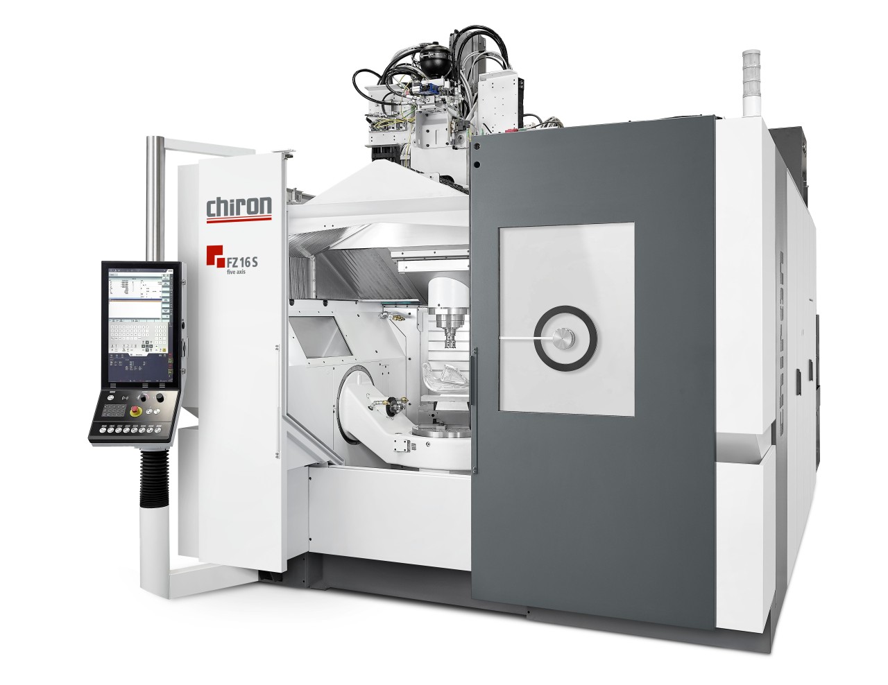

FZ 16 S five axis
With a powerful main spindle offering torque of 400 Nm and an HSK-A100 interface, the FZ 16 S five axis is designed for machining complex structural components from a solid block. The mobile gantry design ensures excellent static and dynamic rigidity, while powerful drives provide the required dynamics. The FZ 16 S five axis with HSK-A100 is also impressive when it comes to precision thanks to the robust basic design and high thermal stability.

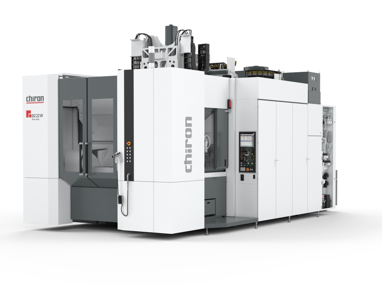

DZ 22 W five axis
The double-spindle machining center is based on the same machine platform as the 16 Series and, with a spindle distance of 600 mm and tool changing during regular machine operation, is particularly suitable for producing large, complex workpieces for the automotive and aerospace industries. The machining center can be expanded to a fully automated complete solution for increased utilization.
