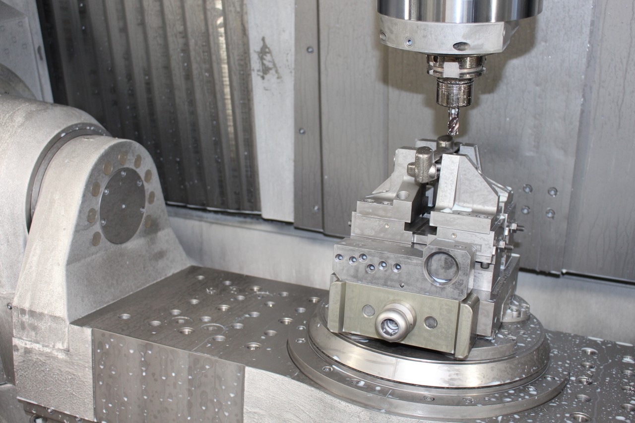

 Machining a tail boom on the CHIRON FZ 15 S five axis machining center.

That's why the clamping concept, for the around 400 different components, played such a decisive role. »We needed to find the balance between the level of investment for the machine and for the mechanisms, because the workpiece side couldn't cost any more,« Roland Ranisch, CHIRON Group Sales Partner, describes the initial situation. »So, using a variety of mechanisms for each part, about half of which would only be used once a year, wasn't an option.«
Together, they developed a robot and clamping concept, which also required compromises on the part of SW-MOTECH. The unmachined parts, or blanks, for certain component groups were thus standardized, so that the same mechanism could be used more often. »Because it's quicker to mill off 5 mm excess material from a blank, for example, than to re-mount,« Ranisch explains. For Jockel, the be all and end all was to remain with the vice as the final clamping element. »This meant we only had to invest once in the base device with zero-point clamping system and only need to adjust the second clamp at the top with the vice.«
