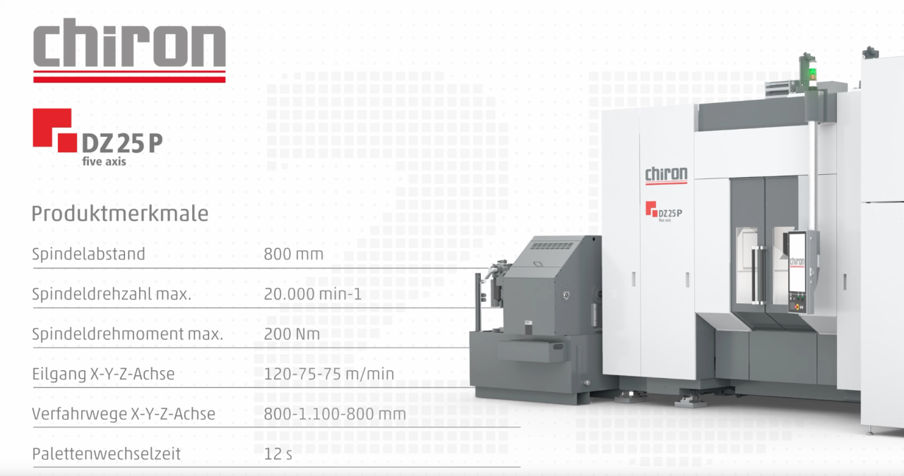

The benefits of the 25 Series at a glance
  • Twin-spindle machining of large-volume components
  • Optimum dynamics
  • Best possible access to the working chamber
  • Independent X-axis and Z-axis compensation
  • Process easily visible thanks to separation of the operating and loading sides
  • Automation via robots or gantry

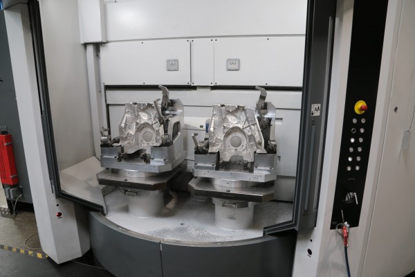

 Loading and unloading during operation using pallet changers guarantees high levels of efficiency.

The aim was to develop a manufacturing system precisely tailored to the needs of automotive suppliers for machining structural components. »We compiled a feature list with a precise profile of requirements for a new, twin-spindle machine concept. Of course, we started from the necessary machining steps, but we also rethought the composition of the machine from scratch. A shuttle table concept for equipping the machine during operation, as well as a quick tool changer for reduced change times. We also had to keep in mind the high safety requirements,« Brunnthaler goes into detail about the design.
 Prioritizing stability and ergonomics
The main focus was on highly productive machining of complex structural components. This was one of the reasons that the CHIRON Group opted for mobile gantry design for the new development, rather than the tried-and-tested a traveling column design. »The result was an extraordinarily stable and rigid machining center which also fulfills all our wishes in terms of precision. We found out precisely which factors are relevant for cycle times and focused on those in particular. It became clear that tool changing and workpiece positioning were crucial aspects for this,« Schmid says. The turntables, mounted in parallel on the bridge of the A-axis with an 800 mm spindle distance, can be fitted on the loading space and swiveled in. Both HS motor spindles run on independent Z-guides, enabling mirror machining and compensation of possible component distortion.

The significant rigidity of the machine allows high dynamics and very fast axis acceleration, as well as fast rapid traverse speeds. Two separate tool magazines with space for 60 tools each, offer independent tool change on each spindle for short Chip-to-Chip times of 3.5 s. With axes of 800 x 1,100 x 800 mm (X/Y/Z), it's easy to machine large parts and the spindle torque of 200 Nm at 20,000 rpm is transferred safely to the tool via a HSK-A63 interface. The new TouchLine operating panel is based on a Siemens 840 D sl.
