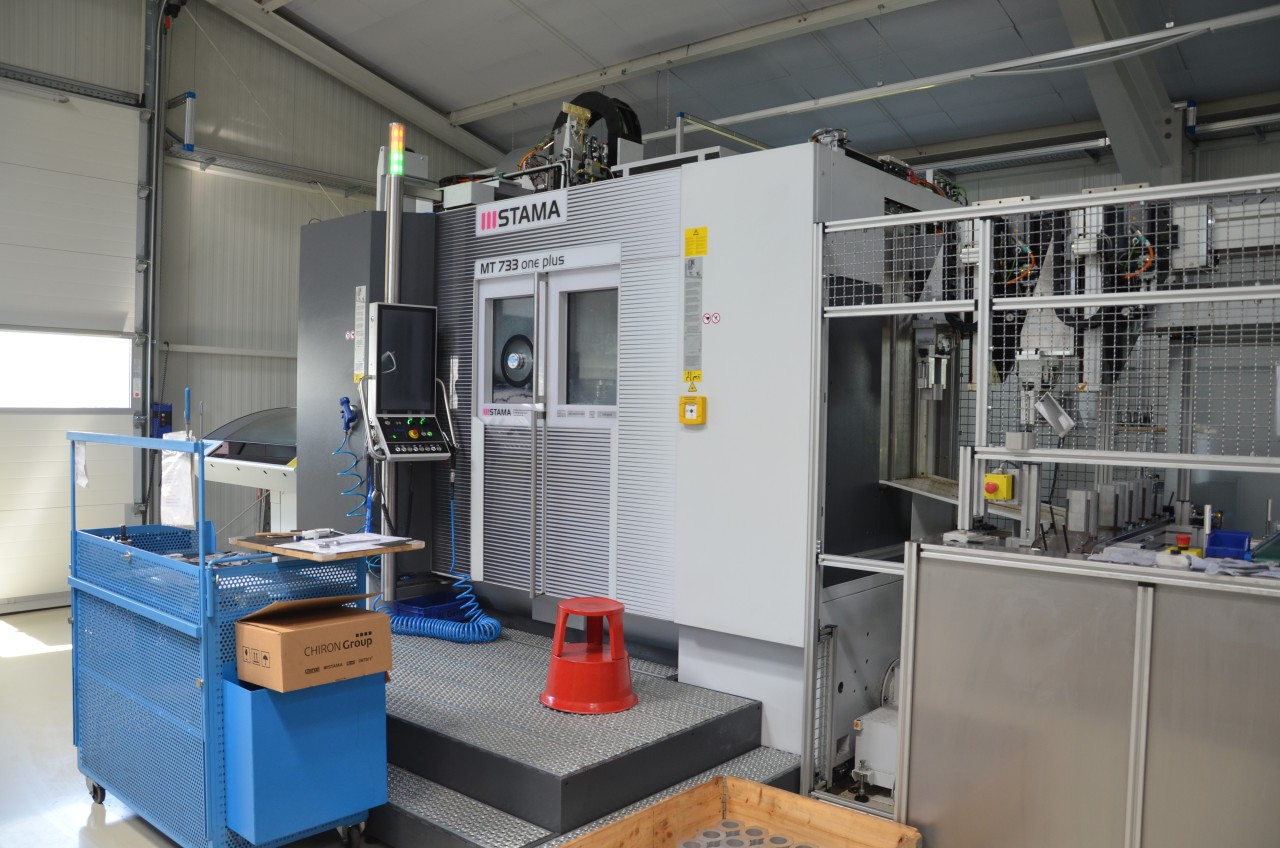

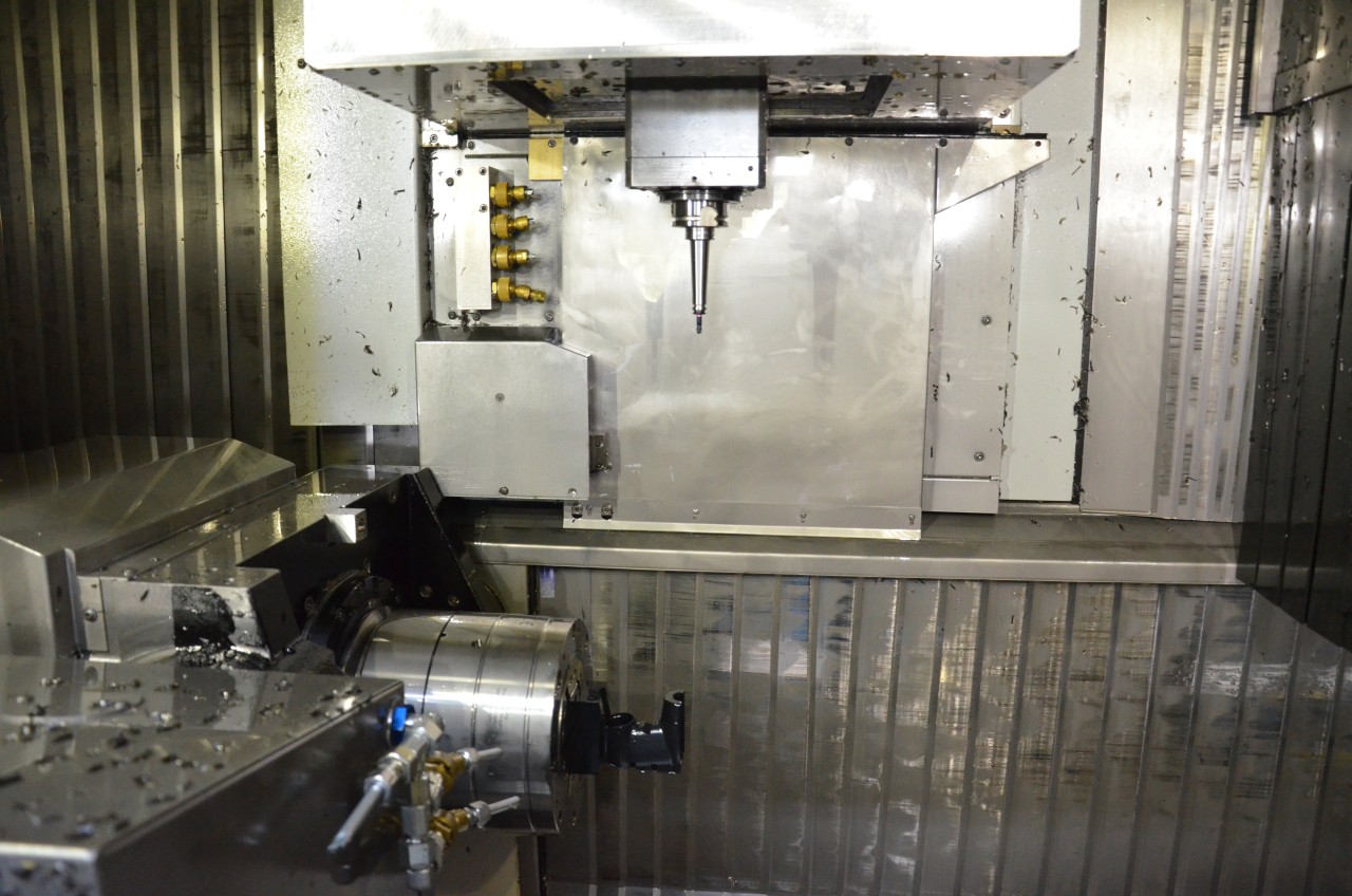

As the successor, the son of the company founder has long been part of the company management. Most recently, the company invested in the purchase of an MT 733 one+ and an MT 733 two. Both machines score particularly highly due to their gantry design, which significantly improves the thermal, mechanical and static stability of the machines compared to the previous moving column machines. As a result, complex and hard-to-machine workpieces can be milled and turned with high precision. For machining of the sixth side, the MT 733 one+  offers a counter-chuck. »With the MT 733 two, five-axis milling and turning is even possible simultaneously in both clamping positions,« said Peter Rapp, the responsible project engineer at the CHIRON Group, to which STAMA also belongs.
»To enable complete machining of the components on six sides, both sides of the machine were equipped with a milling spindle and a turning spindle each.« The solid and thus rigid base frame of polymer concrete also ensures stability. »Both machining positions can work completely independently of each other, without vibrations impairing the machining result,« said Rapp. The components exit the machine with an unusually high machining quality. There is not usually any need for rework, such as grinding. The high stability is also important in the unlikely event of a crash. »With the STAMA machines, a couple of simple repairs is usually all it takes in order to continue working after a crash,« explained Gerdt. »The mechanical precision of the machines is simply amazing!«
 The MT 733 one+ with counter-chuck for six-sided complete machining.   Photo: mav, konradin Verlag
