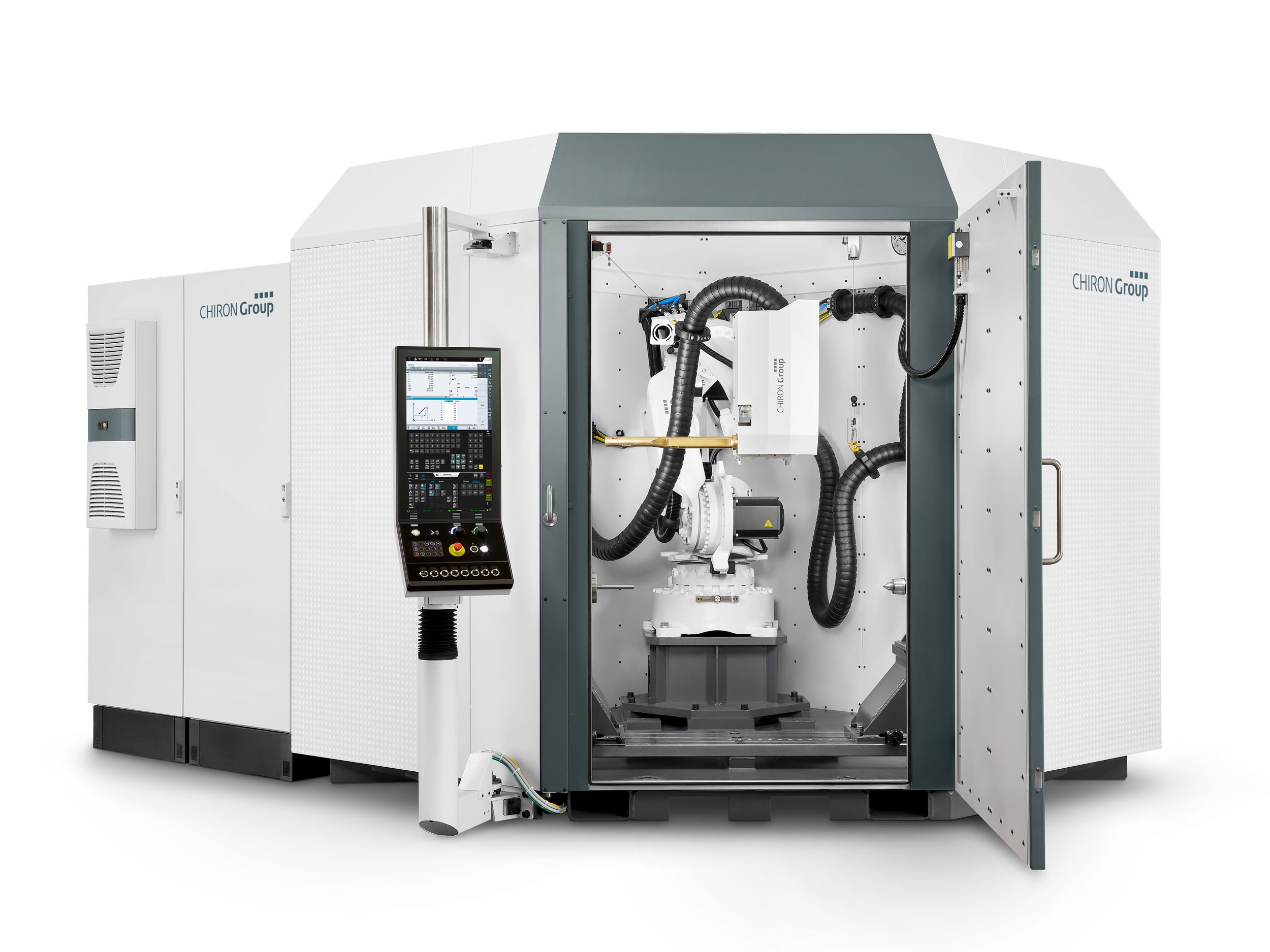

AM Coating's powerful extraction device protects the laser against contamination and operating personnel against exposure.
Advantage of the process for a high coating speed – the powder particles already melt in the laser beam.
Intuitive operation via TouchLine and the laser protection screen provides an unobstructed view of the process.
