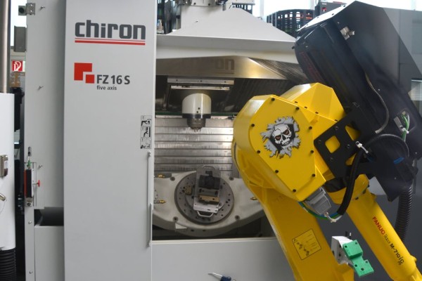

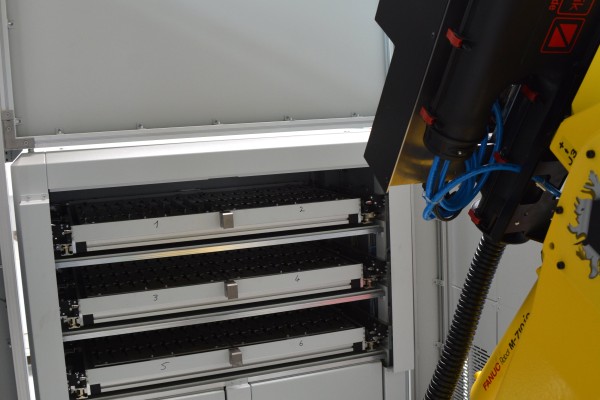

CHIRON FZ 16 S five axis machining center: The quick-to-retool, flexible robot automation with inventory drawers (right) ensures high levels of productivity.

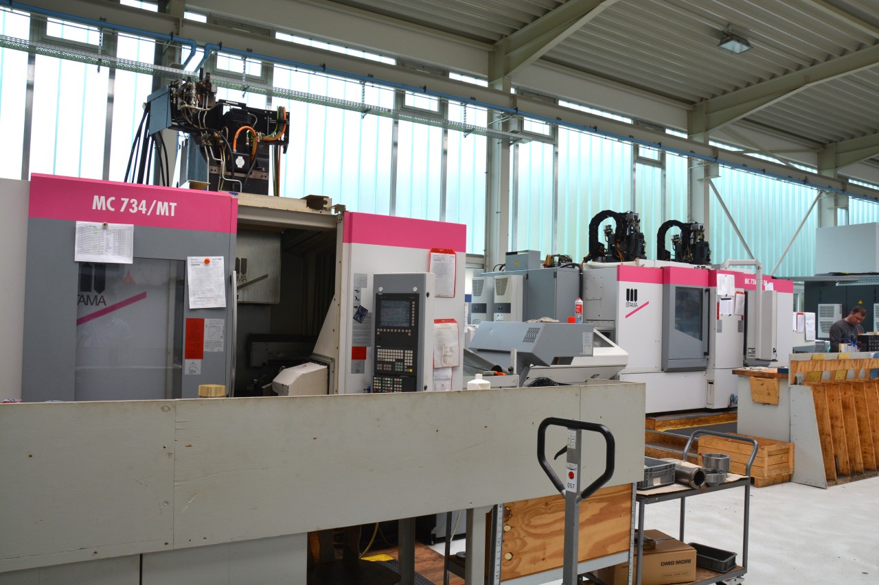

 Endurance runner: Both STAMA milling-turning centers perform reliably and productively.

Thereafter, the firm also purchased a MT 734 from STAMA. Regarding long-term, largely trouble-free shift operation of the machines, Björn Aleit talks about his »reliable marathon runners which are slowly getting older, but have been a fantastic investment.«

The next time Aleit needed to invest was in connection with the complete machining of PSC tools with their various shaft interfaces. The original manufacturers had previously failed to manufacture the complex internal contours including eccentric geometry from one cast. For this task, Aleit selected an F Z16 S five axis which is sold in a package with an individually tailored robot-automation cell. The extremely stable machine concept with a swivel bridge mounted on both sides, was impressive from the start. To this day, the intelligent and, above all, highly flexible and quick-to-change automation unit makes the big difference to productivity.

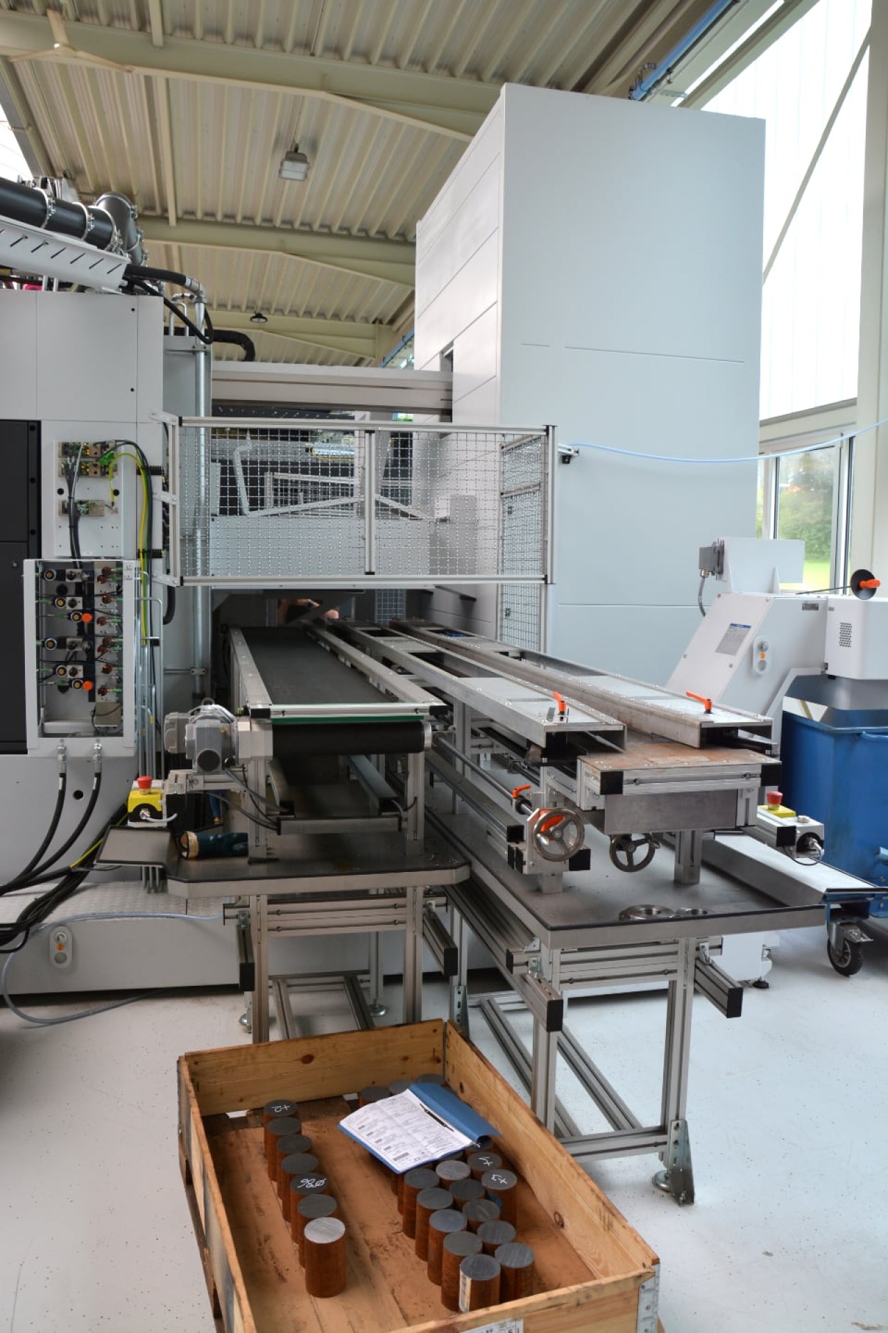

Fully automated six-sided complete machining – the supply and removal belts of the STAMA milling-turning center transport the heavy parts weighing up to 25 kg to the integrated workpiece gripper and back again afterwards. On the right is the connected auxiliary tool magazine with space for 240 tools.

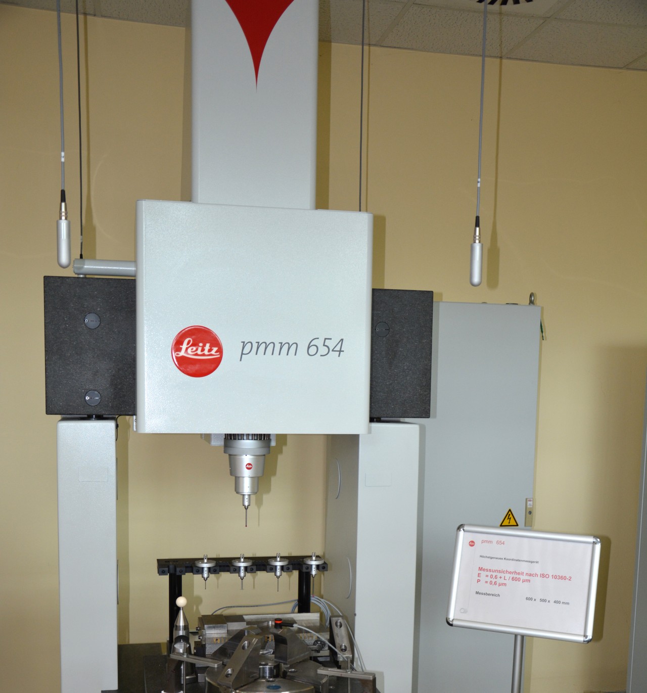

Ten times more accurate than the manufacturing tolerances – the comprehensive documentation of added value at Aleit also includes the climate-controlled 3D coordinate measuring system from Leitz.

It's possible to work with bars up to a diameter of 102 mm, while chuck parts can have a diameter up to 300 mm. The supply and discharge belts can move individual parts weighing up to 25 kg to and from the workpiece gripper, which is located between the two working chambers and manages the transfer from the main spindle to the counter spindle for chuck parts. The machine has an autonomous tool inventory of 64 tools per working chamber and an additional, up-to-240 tools in the auxiliary magazine which is connected via shuttle.

Aleit is, of course, ISO 9001 certified and is therefore very well-positioned today. It now has its own product range that fills an entire catalog. It is also noteworthy, that the firm completely tests all finished parts including documentation on a Leitz climate-controlled and decoupled 3D coordinate-measuring device pmm 654, with a measurement uncertainty of only 0.6 µm, the option for burnishing, the various types of beam (with corundum, glass balls or stainless steel balls), cylindrical grinding and laser marking.
