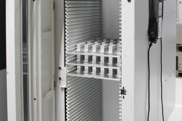

 The workpiece magazine, which can hold a maximum of 24 pallets of size 600 x 400 mm. The part-specific nests are used to hold sawn blanks, semi-finished products or finished parts.

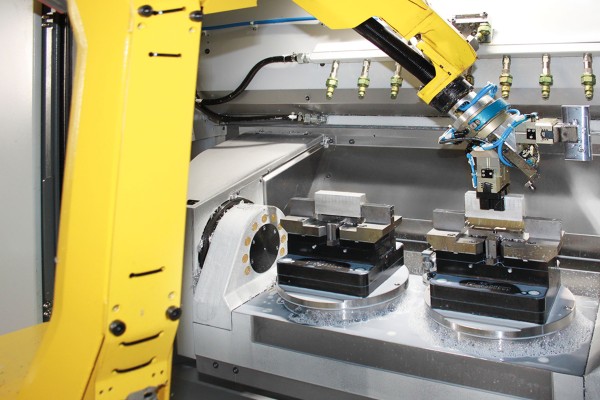

The VariocellUno universal, robot-assisted loading and unloading system is installed for fully automatic workpiece handling. Equipped with a 6-axis robot and a pallet stacking system for pallets measuring 600 x 400 mm, up to 24 pallets can be loaded with (sawn) blanks or finished workpieces can be returned to storage during machining, depending on the workpiece dimensions. Since the magazine and loading system is designed as an independent unit and is only docked to the machining center mechanically and in terms of control technology, access to the work/loading area for manual loading and for changeover/service work remains unrestricted.
 Pickup of a sawn blank from a pallet nest by a robot and double gripper; and then in reverse, after the robot gripper has swiveled, finished parts are returned to the pallet nest.
 Working area of the vertical CNC machining center with retracted swivel table for successive five-axis complete machining of two workpieces at a time.
