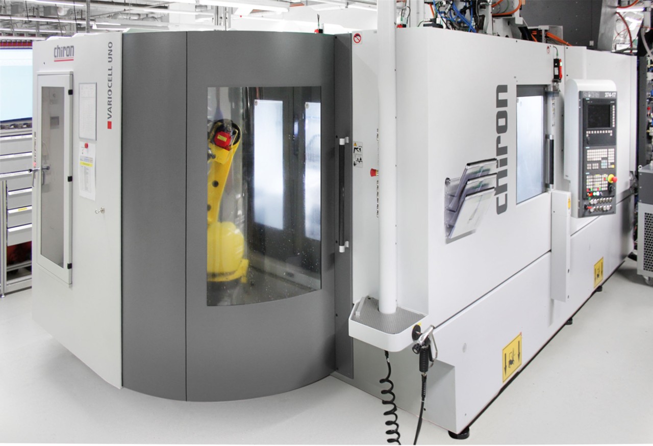

 The new fully automated manufacturing system at Mettler-Toledo GmbH; in front the compact VariocellUno automation unit and behind it the FZ 15 W five axis vertical CNC machining center with integrated workpiece changer.   Photo: Publica-Press Heiden AG

Accordingly, the new, fully automated production system for Mettler-Toledo consists of an FZ 15 W five axis vertical CNC machining center with workpiece shuttle table, which has travel distances of X=730, Y=400 and Z=360 mm and operates at spindle speeds of up to 15,000 rpm and a max. torque 140 Nm. Equipped with the well-known very fast automatic tool changer (change time 0.9 s or chip-to-chip time 2.4 s), the optionally extended tool magazine with 64 places, the integrated workpiece changing device (change time approx. 3.5 s) with 2-axis swiveling device (swivel axis as A axis and NC rotary table as C axis) and feed drives for rapid traverse speeds of 75 m/min in the X, Y and Z axes, all the prerequisites for highly dynamic complete machining are already met in the basic version. Other features include: Siemens 840D solution line CNC control system, automatic temperature compensation, Cycle 800 software module including kinematics data for machining tilted surfaces, automatic zero point calculation, reinforced coolant system, Lasercontrol Single F1000 tool breakage control system and probe for measurements in the machine.

The VariocellUno universal, robot-assisted loading and unloading system is installed for fully automatic workpiece handling. Equipped with a 6-axis robot and a pallet stacking system for pallets measuring 600 x 400 mm, up to 24 pallets can be loaded with (sawn) blanks or finished workpieces can be returned to storage during machining, depending on the workpiece dimensions. Since the magazine and loading system is designed as an independent unit and is only docked to the machining center mechanically and in terms of control technology, access to the work/loading area for manual loading and for changeover/service work remains unrestricted.
