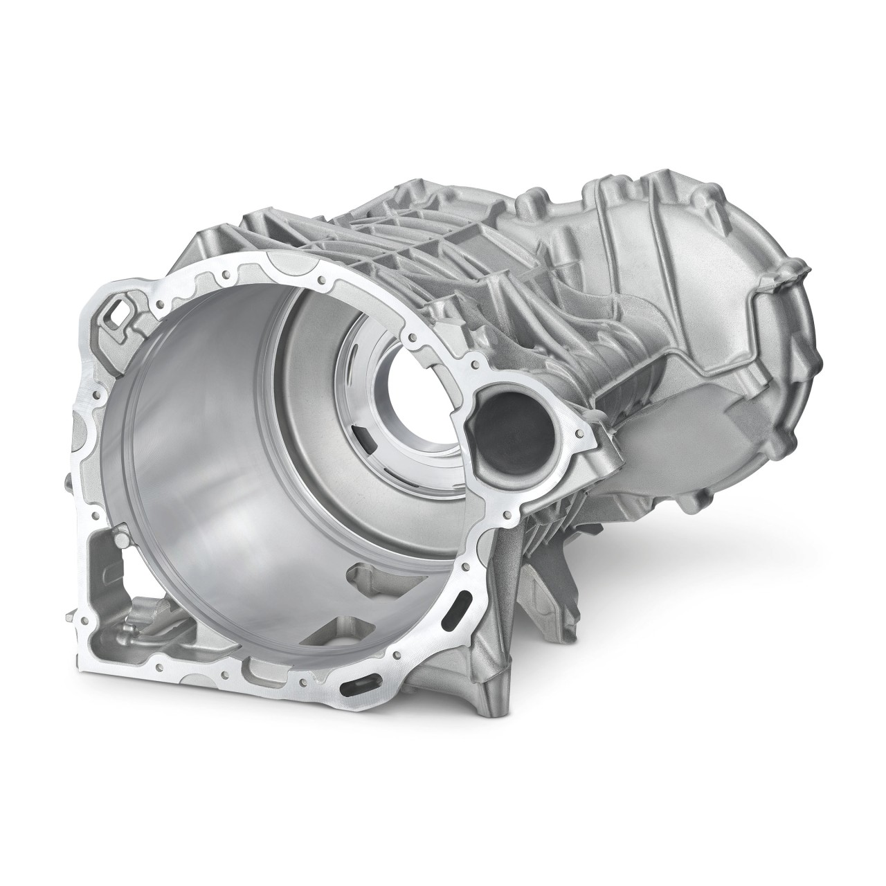

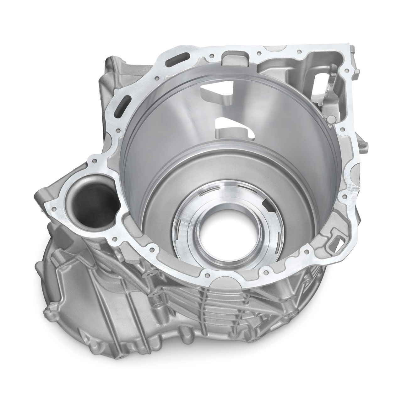

Machining housings for e-mobility – all the possibilities with the 22 Series
Whether a stator, rotor or e-motor housing for diverse hybrid variants or for an all-electric car: Since 2020, the 22 Series from the CHIRON Group enables them to offer the appropriate manufacturing technologies for components with a diameter up to 600 mm. And a variety of options for dynamic, precise machining for reduced unit costs: 4- or 5-axis. Single or double spindle. For difficult machining with high torque. Manual loading or automated with a robot or gantry.
So, lots of options. However, according to Michael Rothenburger, Head of Core Workpieces Automotive, »nobody must remember them. What matters is that we can use these options and our expertise in automotive to design a manufacturing process that exactly according to the requirements.«
E-motor housings: one workpiece, many variants
»At the beginning, when e-mobility was having to establish itself and accordingly the variety of components was high, then the production concept to recommend itself was mill-turning, more precisely STAMA MT technology. Today, the next generation DZ 22 S mill turn system 8 machining centers are suited for this type of machining. In contrast, when machining large quantities, ideally the double-spindle machine types DZ 22 in combination with special tools that are used,« explains Gerhard Ulmer, Head of Sales Industries. In his view, the 22 Series machines offer »a huge advantage: The processes from the MT technology can be transferred one-to-one to series production. The operating personnel are already familiar with it. The components within the 22 Series are the same – keyword: spare parts – and automation can be scaled accordingly. All of this increases machine availability and reduces the overall operating costs.«
