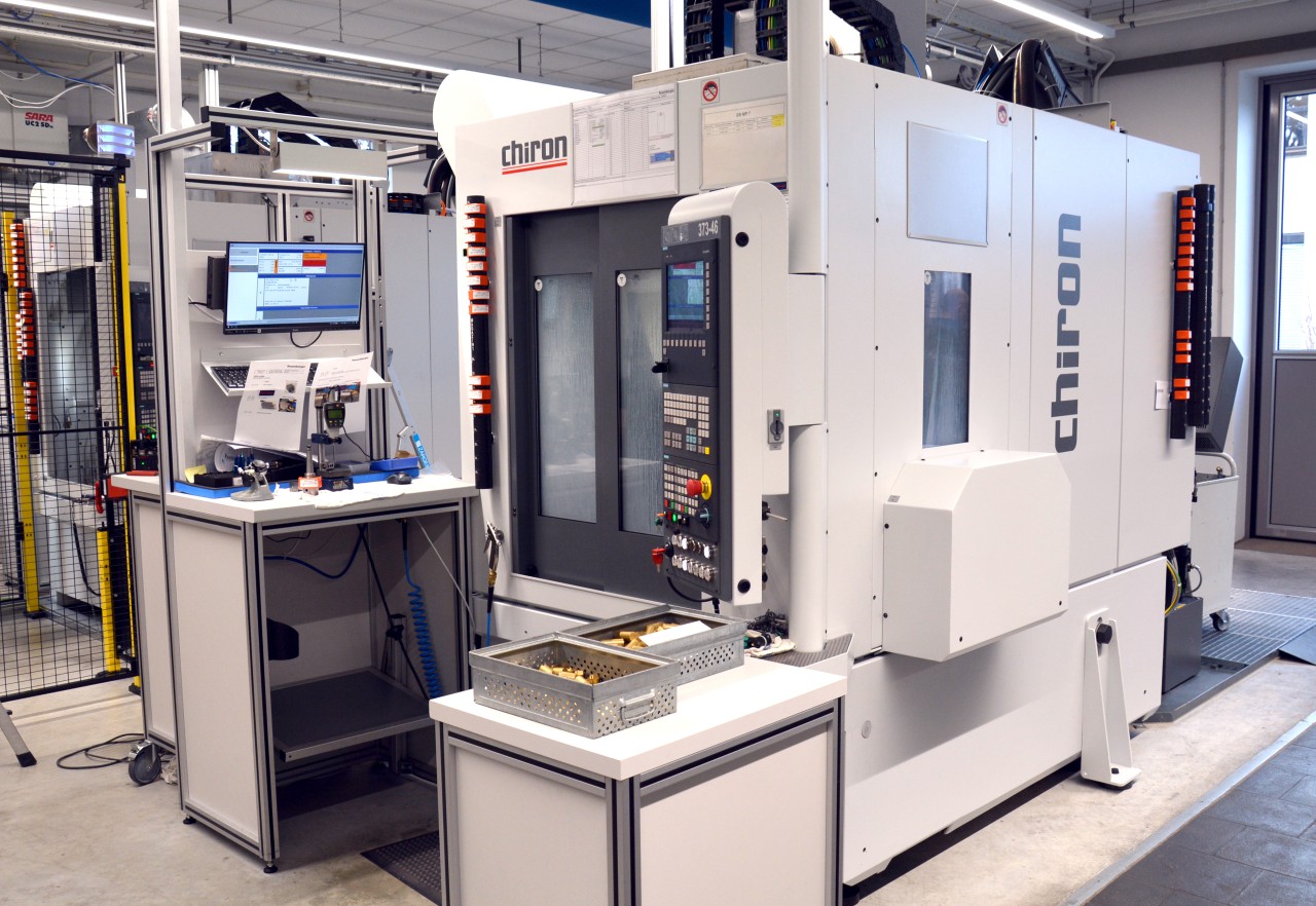

 Precision components for high-precision testing and inspection technology: As a result of increasing miniaturization in high-voltage applications, Rosenberger relies on extensive complete machining with the aid of two »FZ 12 S five axis« machining centers from the CHIRON Group.   Photo: Carl Hanser Verlag GmbH & Co. KG

Christian Schmid has the following summary for the project, which lasted almost two years: »Our goal was to have contemporary processes on precision machines that can keep pace with developments on a continuous basis. Therefore, the decision was made in favor of two identical CHIRON machining centers of the FZ 12 S five axis type.« Beginning with the initial contact with the Tuttlingen-based machine builder in April 2019, the entire process – from the project planning that took place in May 2020 through to the scheduled delivery of the machines in November 2021 and February 2022 – was conducted successfully despite the pandemic-related restrictions. Numerous discussions and carefully researched specifications provided the basis for this success.
Fast, precise, universal and future-proof
Over the course of the assembly, the essential requirements quickly became clear. As Thomas Fellner puts it: »The wide variety of connectors for test applications contribute significantly to the utilization of our milling capacities. Their complex external and internal geometries require a variety of tools. This brought short chip-to-chip times into focus. At 2.6 s, the FZ 12 S five axis offered the greatest potential in this regard among a comparison of competitors. Intricate connectors also have tighter tolerances. For function-critical dimensions, this is often ±5 µm with regard to shape and positional tolerance, which requires an extremely high level of positional accuracy from the machines. To this end, the CHIRON Group offered us the sample machining of two selected components in Tuttlingen, Germany, which allowed us to make a direct comparison to the previous processes. Both were mastered with flying colors and additionally resulted in significant main time reductions of 30 percent or more. This – along with the other good impressions we obtained from Tuttlingen – dispelled any reservations on our part. It's worth reminding that we'd had no experience with the CHIRON Group prior to that point.«

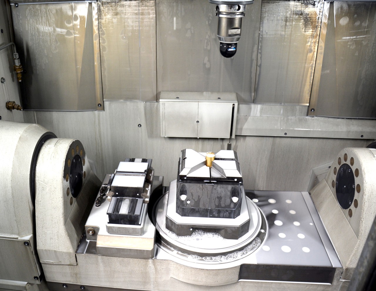

Franz Schuhbäck adds the following: »Since we also have components with OP 10 and OP 20, which previously had to run through two separate machines, the possibility of complete machining was important to us for reasons of productivity and precision. To this end, the FZ 12 S five axis machines have a secondary clamping surface in addition to the face plate. Furthermore, the analysis of our parts spectrum has revealed average batch sizes between 500 and 1,000 and this is the case for variant-rich repetitive parts with run times in the minutes range. The machines should therefore also be able to be converted quickly. The accessibility and the overall concept of the FZ 12 S five axis machines have noticeably reduced our expenses in this regard. For the not infrequent case that a sample part becomes a series part, rational NC program handling was also important to us, i.e. ensuring a short path to the first good part. Thanks to all the features – from the modern Siemens 840D sl type control system and the fast processors through to the user interface – there's nothing left to be desired in this respect.«

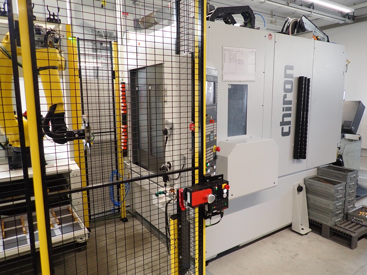

 On its own initiative, Rosenberger is adapting a robot-supported automation system with blank handling to one of the FZ 12 S five axis machines; both CHIRON machines inherently possess all the necessary prerequisites for this.   Photo: Rosenberger Hochfrequenztechnik GmbH & Co. KG

In the interest of short set-up times, Rosenberger docks the clamping devices – which are primarily produced by the company's own fixture construction division – onto a zero-point clamping system that is used throughout the production process. The workpiece change of the saw sections is then carried out manually by the operating personnel for non-automated machines. In order to fully utilize the machine's traverse paths, the CHIRON Group has integrated the zero-point clamping system for Rosenberger directly into the C-axis, essentially doing away with a face plate. This reduces the installation height by 50 mm and also increases the changeover accuracy thanks to a lower number of interfaces. Andreas Schiechel provides further explanation: »Even with such individual requirements, the difference from manufacturers who offer off-the-shelf machines becomes apparent. The price is higher, of course, but a look at the design of the CHIRON machining centers nonetheless proves that we are talking about two different worlds here.«  In general, the project work in partnership with the CHIRON Group has left positive impressions on Rosenberger.
 View of the swivel bridge of the five axis machining centers and of the auxiliary clamping surface (located on the left), which provides valuable services for the complete machining of components.   Photo: Carl Hanser Verlag GmbH & Co. KG
