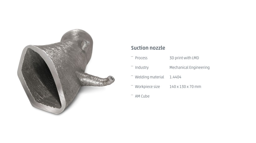

 From coating of components to repair and near-net-shape production of semi-finished products with automatic application head change: It’s all possible with the AM Cube.

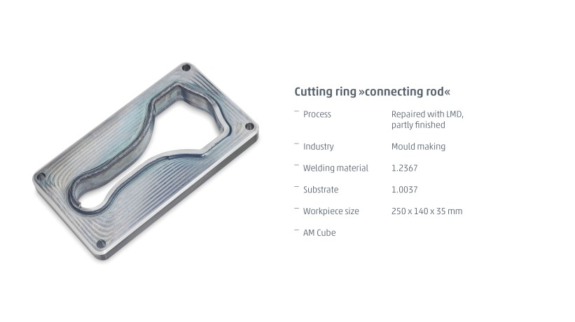

Basically, wherever LMD – whether conventional or high-speed – does not simply replace a previous process like-for-like, but offers an added advantage: longer service life, a faster process, another useful material property, reduced energy consumption, consistently high quality. An example from the energy sector: A large gear wheel that drives a wind turbine is very costly and energy-intensive to manufacture. The energy balance can already be significantly improved by using recycled steel. If this wheel is not replaced with a new one when it wears out, but is repaired in an automated LMD process, this again saves a significant amount of energy. Or, from mold making: In this case, the AM Cube is increasingly establishing itself in the repair of forging molds such as dies, cutting tools or casting molds up to 1,000 kg and with diameters up to 1,000 mm. If cutting rings are welded automatically using LMD, the tool life increases by a factor of 2.5 to 3 compared to conventional manual welding. The application of protective coatings to tools is particularly interesting for highly abrasive applications in the mining, marine and agricultural sectors. This increases the service life of the often expensive tools. Fully coated tools also wear evenly and do not need to be replaced when only one heavily stressed part is worn. In this area, we are working to replace older processes such as plasma coating or high velocity oxygen fuel (HVOF) coating. The aim is to save on energy and raw materials and thereby reduce manufacturing or repair costs.
