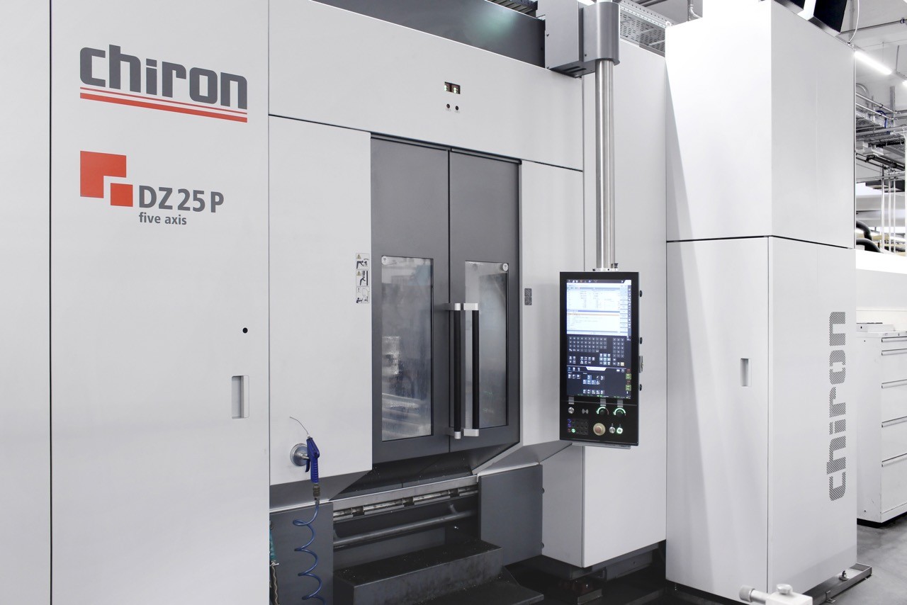

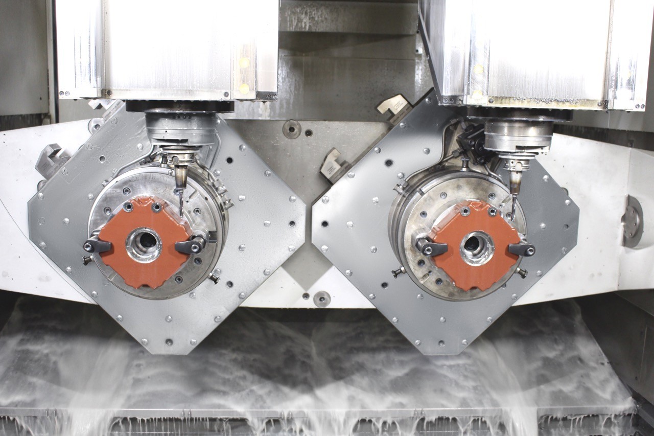

This specific project involved the machining of gray cast iron bearing shields and flanges for servo drives of the Simotics S-1FT7 series – these are permanent magnet synchronous motors with very compact dimensions. Franz reports: »There has been a trend there in recent years toward larger quantities. We had several machine tools in use for the product range, but they did not produce as efficiently. Therefore a double-spindle machine was the obvious choice for expanding capacity. So the concept was set and the choice fell on the CHIRON DZ 25 P five axis machining center with pallet changer and a spindle distance of 800 mm, which we decided on because we also wanted to be flexible for larger components. The fact that the spindles are adjustable in the two axes X and Z also spoke in favor of the machine. In addition, we produce aluminum components for the asynchronous main spindle drive on the twin spindle machine with a cycle time of 2.5 to 3 minutes, which we were previously purchasing from an external supplier.« During operation of the machine, which was installed in March 2021, another design feature proved to be advantageous: The separation of the loading and operating sides. Programming is done on the operator side and the large window with a view of both spindles is located in the working area. On the loading side, this allows for optimal material supply and removal so that the operator can load cleanly. This also simplifies automation, because the robot and safety fence are located in front of the loading side, while the operating side always remains freely accessible.
Virtual machine reduces set-up times
A special feature at Siemens is that the double-spindle machine, which is operated in three-shift operation, is set up at least every two days. »Currently we are machining about 20 different component variants on the DZ 25 P,« says digitalization expert Franz. »During set-up, the main effort is on the clamping devices and we have further reduced the time by converting from mechanical to hydraulic clamping. Otherwise, only the NC program is changed, because the required tools are all in the magazine with 2 x 60 places in the machine.« Schimansky adds with regard to the general assessment: »Here you can see that a twin spindle machine pays off even for smaller batch sizes when the preparation time for set-up is very short thanks to the virtual machine and the ProcessLine system.« So back to digitalization. Siemens uses almost all digital solutions from the CHIRON Group SmartLine software portfolio. For example, the ProtectLine system is used for process monitoring, with which collisions can be avoided on the basis of a digital twin of the machine model. »The simulation in the control system runs 0.8 s before the real machine, so that a crash is reliably prevented,« explains the sales engineer. Adaptive feed control is also installed on the Sinumerik 840D solution line control system. During the process, it changes the feed data from the real load data. Franz describes: »The NC program for the part remains the same, but the software can adjust the feed rate of the tools up or down within the specifications. For our gray iron castings, this has allowed us to reduce cycle times by 3 to 5% on average.«
A small solution with considerable effect is the retooling program. It is called up in the control system during set-up and then ensures that the machine sorts the tools for the next job, so that they are in the optimal sequence in which they are needed. »This shortens tool change times and when machining aluminum components has enabled a time saving of 4 to 5%,« says Franz.
Output has significantly increased
His final conclusion is correspondingly positive: »The DZ 25 P gives us a much greater output, 50% due to the double spindle capability alone and another 25% via the shorter machining time, because, supported by the software tools, it is much faster. Together with the possibilities from virtual simulation and programming, we were able to significantly increase productivity.«
