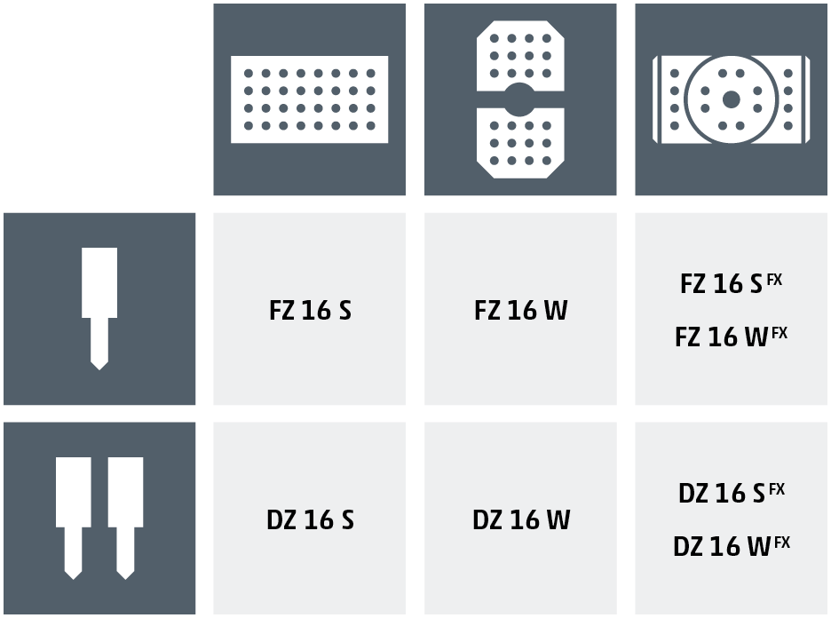

Maschinenvarianten
machine-variant-series16-fiveaxis
