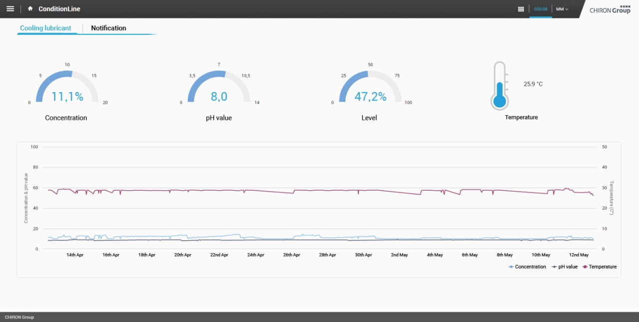

Incorporating fluid management into the machine controls of the CHIRON Group machining centers offers a number of advantages when combined with the Easy Monitoring App: All relevant values such as the concentration, pH value, conductivity, temperature, and fill level can be viewed directly. Plus, the data can be transmitted to the CHIRON Group and to MOTOREX, with the customer's consent of course. This allows the professionals to provide direct support. The system can intelligently top up and automatically maintain the fluid. When the first shift starts on Monday, the emulsion is just right and the tank is topped up to perfection.
 Relevant cooling lubricant factors displayed on the ConditionLine dashboard.
