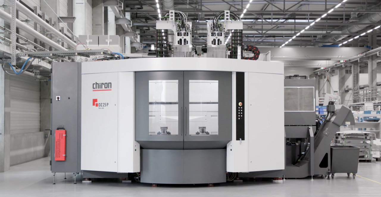

FZ/DZ 25: The new standard for large components
The new CHIRON 25 series is designed to be compatible with the high-productivity machining of complex, large-volume structural components for the automotive industry and aviation. The entire process is easily accessible and completely viewable – a novel feature for workpieces of these dimensions.

  • Twin-spindle machining of large-volume components
  • Optimum dynamics
  • Best access to the working area
  • Independent X- and Z-axis compensation
  • Process clearly viewable thanks to separation of control side and loading side
  • Automation via robots or gantry
