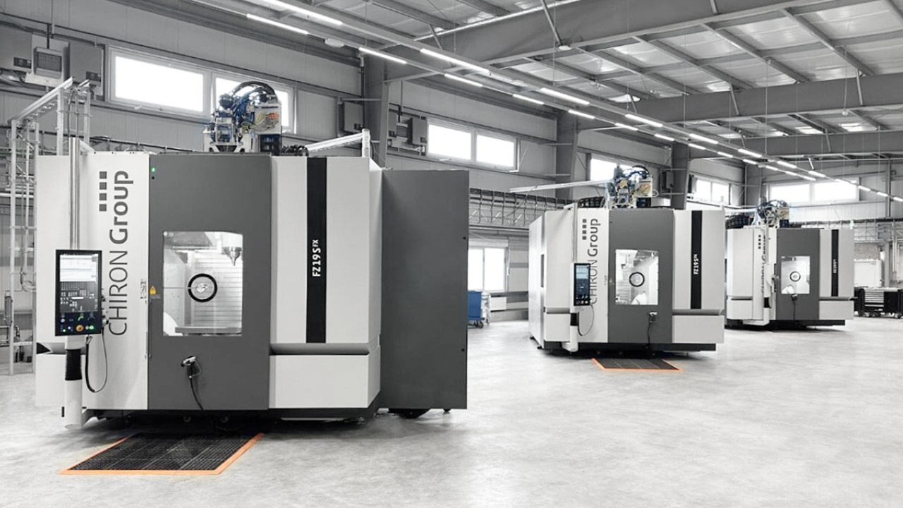

The applications could not be more different. And yet both customers opted for the FZ 19 S five axis, the first machining center in the new 19 Series, even before it was launched on the market.
Senior Product Manager Markus Vollmer says this shows that »Our development strategy was exactly right. We wanted a machine with universal application possibilities. Flexible, of course. But that's what everyone is counting on. We have equipped the FZ 19 S five axis with the necessary power to precisely machine materials such as Inconel or titanium. And with the corresponding milling performance and dynamics to also manufacture series highly productively on a single-spindle machine in a compact space.«
Another key advantage of the FZ 19 S five axis: With 700 mm travel in Z, the working area is designed to be ideal for 5-axis simultaneous machining of workpieces with a cubic capacity of up to 580 mm or cylinders up to 820 mm in diameter and 700 mm in length. The first machine variant of the new series is also available with an HSK-A100 interface and a maximum spindle torque of 408 Nm for machining components from blanks, for example for aerospace applications.
The cubic working area with 700 mm travel in Z is ideal for demanding 5-axis machining of impellers, for example.
As with all CHIRON Group machining centers, the modular design allows individual configuration exactly according to requirements. For example, with motor spindles developed and manufactured in-house, various rotary table packages and tool magazines in three sizes each for the HSK-A63 and HSK-A100 interface, with capacity for 36 to 196 tools.
