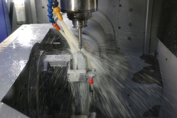

In the meantime, Märklin's main area of production has changed again. The Göppingen-based company currently has a total of six machining centers – three FZ 08 models, two FZ 08 models and one FZ 12 model – primarily for producing the structural and locomotive housing. The business now uses industrial motors for its drives. While these are bought in from elsewhere, they significantly improve the level of detail in the structure and locomotive housing sections. The experts at Märklin say that this results in the constant challenge of finding a middle way between what is possible from a casting perspective or what is only possible with a great deal of effort, and what can subsequently be achieved more cost-effectively using a machining center.
»We're now using a fourth generation of machines from CHIRON. Everything is going very well and our partnership is working perfectly,« Gaißert explains. He particularly emphasizes the quality of support provided for process time generation and feasibility studies, adding that test machining operations are also possible. »Two years ago, we were at CHIRON's premises because we wanted to try something new – we milled a semi-finished product into an undercarriage. We first programmed it here and made various attempts, but we weren't fully satisfied with the outcome,« remembers Sven Dannenmann, Head of Diecasting and Cast Iron Machining at Märklin. »We then approached CHIRON and they redesigned the program and produced samples.« Gaißert adds, »At the time, this production set-up was uncharted territory for us. While we did have a five-axis machine, we only used it for positioning because we needed to make holes at suitable angles. For this project, we wanted to mill a solid block into an undercarriage for the small Z track gage, which was something we'd never tried before.« Dannenmann continues, »If we are working on a new product in-house during the design phase and our experienced on-site specialists are reaching their limits in terms of technical manufacturing, we contact CHIRON and know that we'll be supported by a skilled partner.«
Bernd Hechler, Technical Consultancy/Sales at CHIRON, states »Development is 100% in Märklin's hands; CHIRON is only brought in if it there are applications where our specialists need support.« As one of the greatest challenges for Märklin is making its products as realistic as possible, the departments involved in development and production are included in order to recognize and resolve any problems at an early stage.
Depending on the part interdependencies, Märklin produces between 80 and 200 housings and attachments a day. The runtimes for each part can vary considerably, depending on the parts' complexity due to their features and details. »Sometimes a part like this can take up to four minutes,« Gaißert explains. »But there are also simple workpieces which can be made in 30 seconds.«

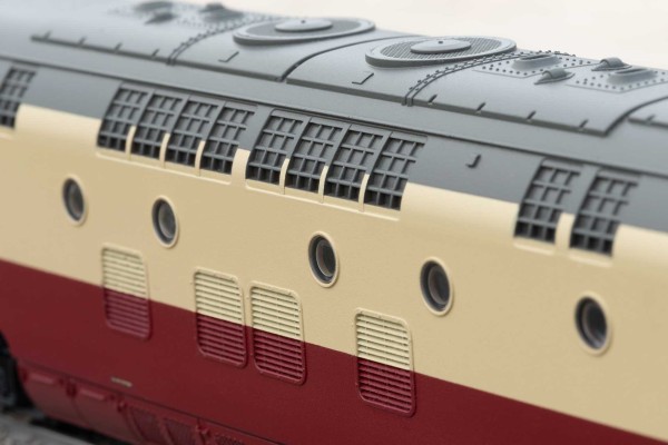

Gaißert says that Märklin produces a relatively high number of new products every year – like the current »TEE Edelweiss«, a four-carriage train with all of its attachments made from diecast metal. »Model train collectors expect new innovations at regular intervals. They must all pass through production in a timely manner and on schedule,« states Gaißert. »This entails a great deal of effort in preparation, as the partner parts must interact perfectly and we machine a large number of high-precision items.«
 The »TEE Edelweiß« of Märklin.  Image Source: Märklin
