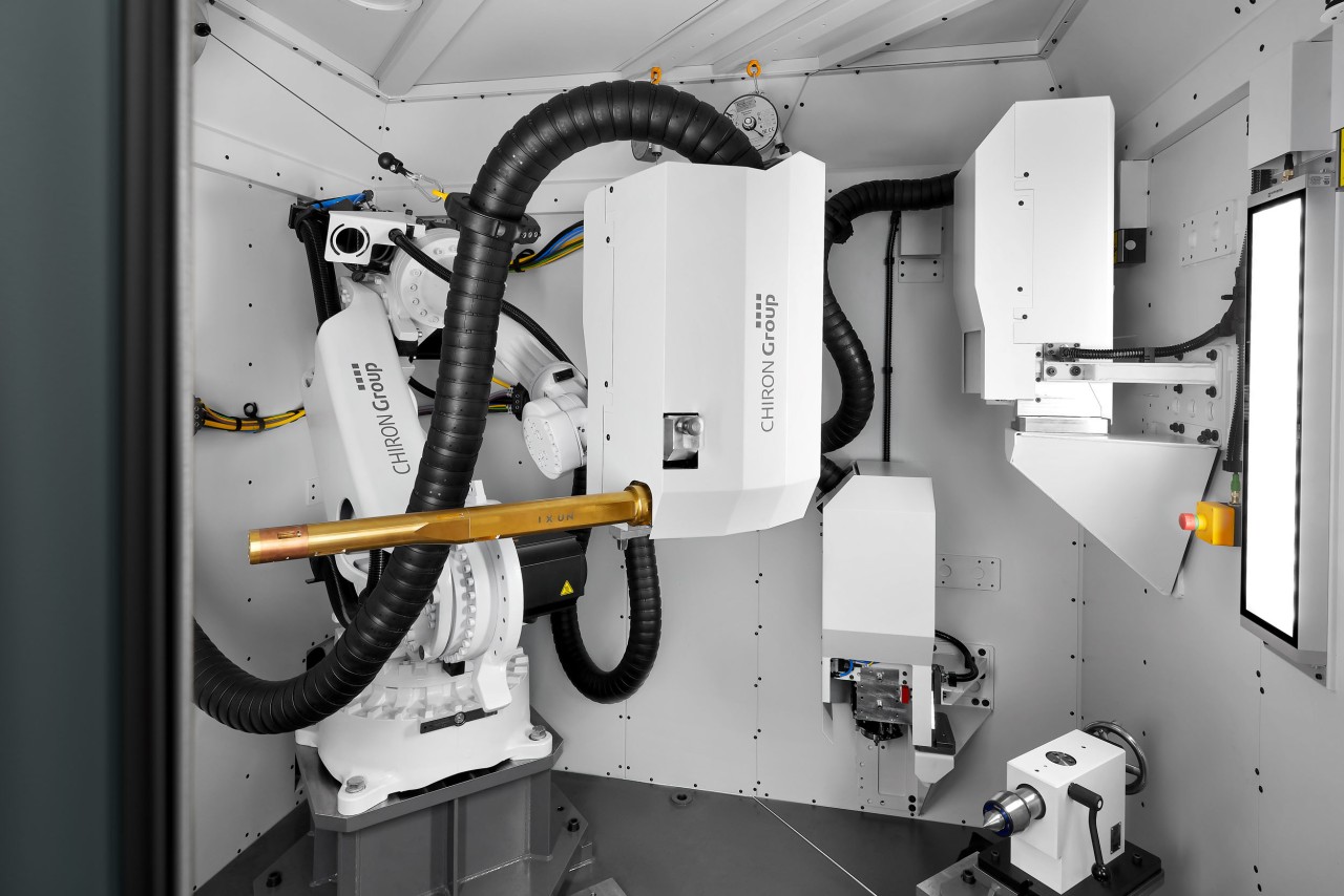

 Deposition head for internal coating, two other heads are in the park position.
