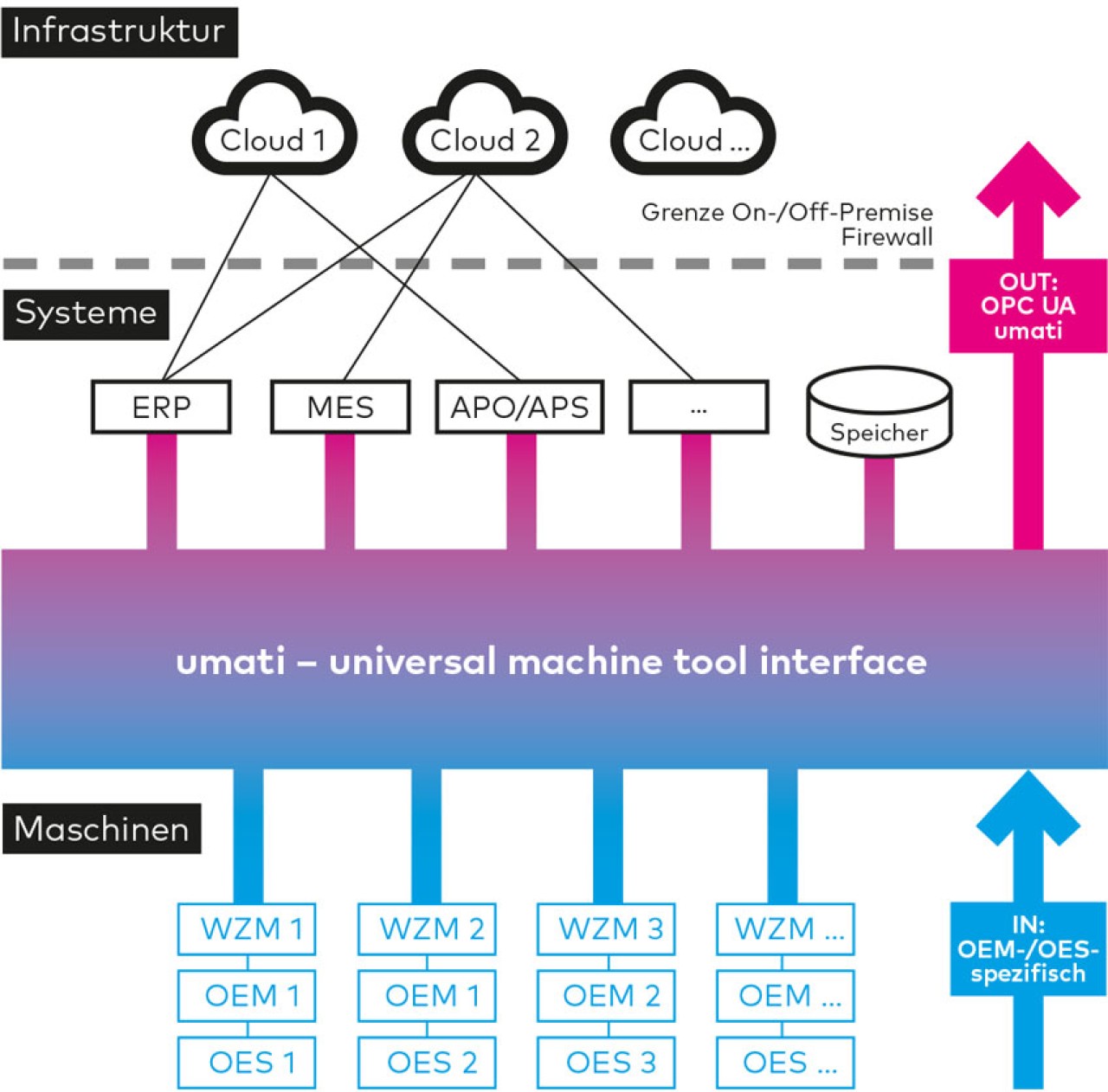

The more easily machines from different manufacturers »communicate with each other«, exchange information and use it together, the faster and better the potential for increased productivity can be tapped. This is precisely why the VDW industry initiative is laying the foundation with umati. umati is a universal interface, which is establishing itself worldwide as an open standard for the machine tool industry.

For the first time, umati offers the possibility of simple and defined integration of machining centers in superordinate MES or ERP systems. umati is based on the OPC UA interface standard, which is becoming increasingly established in machine and plant engineering. The advantages are platform-independent, cross-manufacturer communication and integrated mechanisms for high data security.

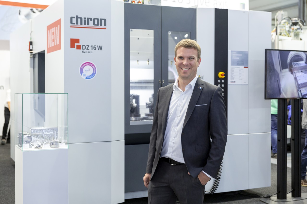

The CHIRON Group has already demonstrated how networked production works in practice at the EMO 2019 using a DZ 16 W five axis machining center with umati interface.The machine was integrated in both the VDW-Cloud and the CHIRON DataLine. In addition, umati was used to integrate other external machines from different manufacturers in DataLine. Using DataLine, it was possible to determine, analyze and visualize machine information from the CHIRON machining center as well as from the external machines live.
