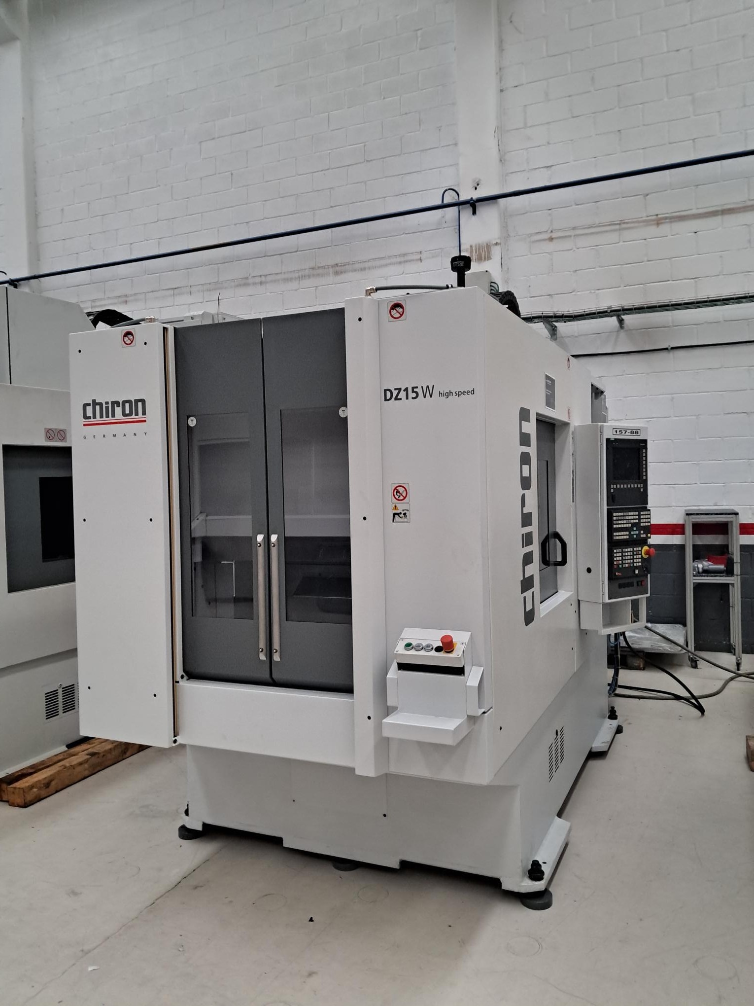

Highly productive double-spindle machining center with a fast basket tool changer (2 x 12 tool places) and workpiece changing device for loading and unloading during machining.
All the details at a glance
Technical data
Traverse paths X – Y – Z max.
300 – 400 – 425 mm
Power max.
14.00 kW
Number of spindles
2
Spindle speed max.
12,000 rpm
Chip-to-chip time
2.10 s
Rapid feed X – Y – Z max.
60 – 60 – 60 m/min
Number of tools max.
2 x 12
Tool taper
HSK-A63
Workpiece changing device
CHIRON-basket-tool changer
Table
Workpiece swivel table
Clamping surface
2 x 660 x 400 mm2
Control
Siemens 840D
Existing special equipment
  • Automatic loading door
  • Chip conveyor 1,050 mm
  • Coolant equipment
  • Hydraulic unit
  • twin spindle
