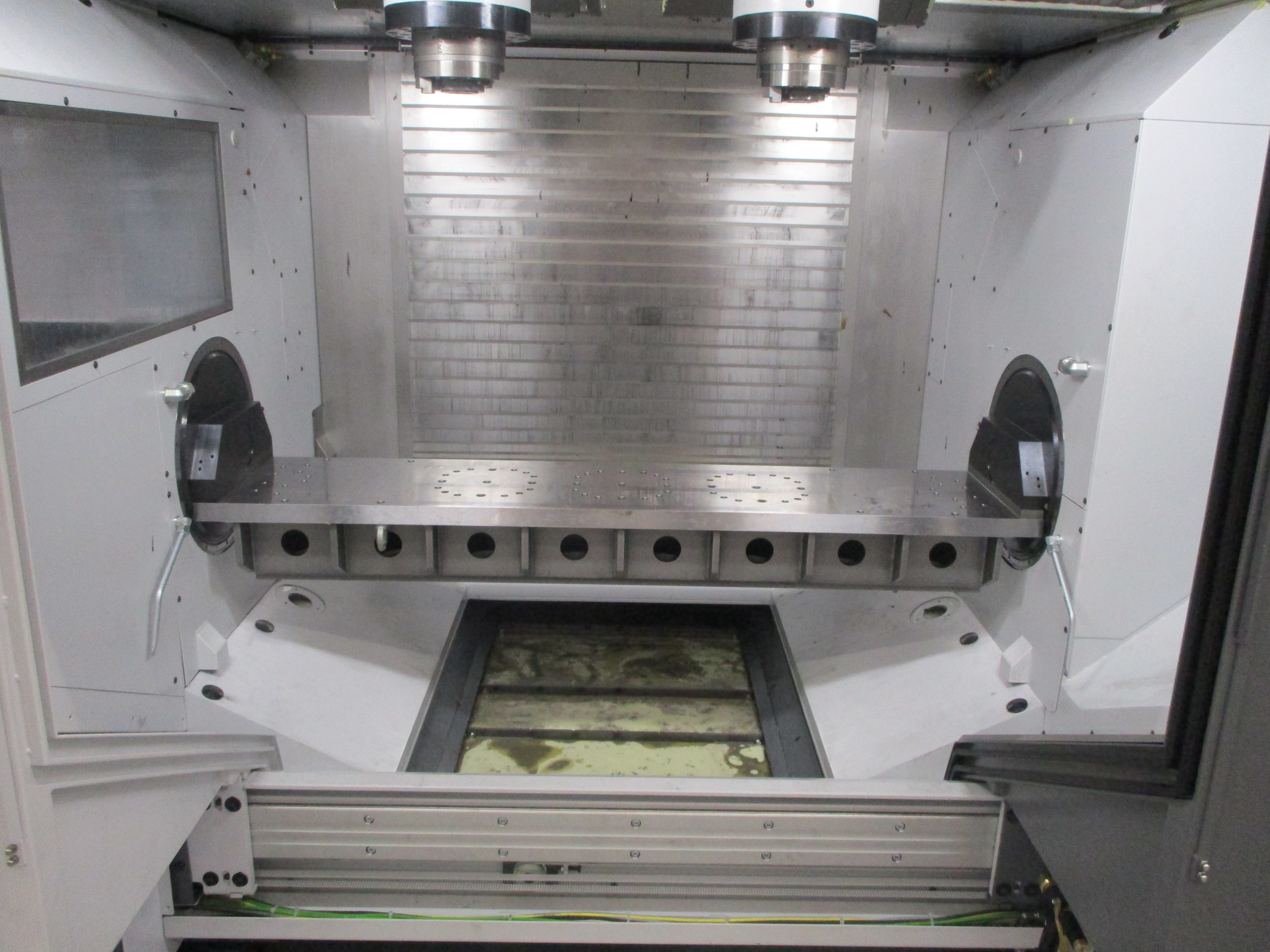

  • Double spindle machining of large components in short cycle times
  • Rigid machine bed with a mobile gantry construction for high precision
  • Active cooling of all components
  • Tool change during machine operation for maximum output
  • Process is easily visible thanks to the separation of operating and loading sides
  • Workpiece changer for loading and unloading during machine operation

Traverse paths X – Y – Z max.
620 – 960 – 600 mm
Power max.
57.00 kW
Number of spindles
2
Spindle speed max.
20,000 rpm
Chip-to-chip time
2.20 s
Rapid feed X – Y – Z max.
75 – 75 – 75 m/min
Number of tools max.
2x42
Tool taper
HSK-A63
Workpiece changing device
Table
Rotary tilting unit
Control
Fanuc 31iB5
Existing special equipment
  • Chip conveyor 1,050 mm
  • Exhaust fan 1.100 m³/h
  • Probe - package RLP40Q
  • Whisker switch
  • Electric interface for loader with Profinet
  • twin spindle
