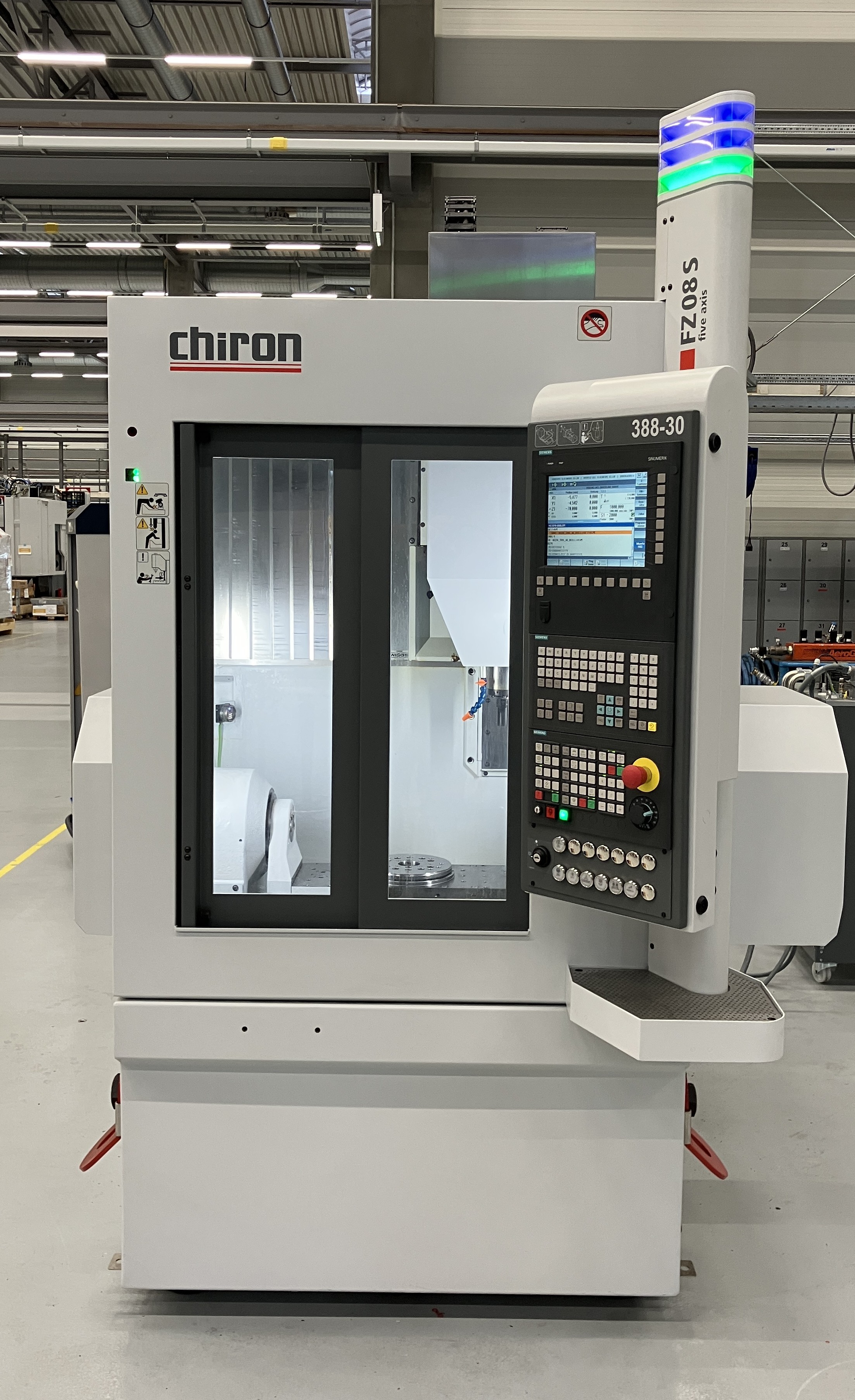

FZ 08 S five axis
08 Series
2 months
New machine
12 Months Warranty
  • Reliably strong performance
  • Compact machine layout
  • Vertical moving column principle
  • Steel/mineral-cast machine bed
  • Motor spindles with water cooling
  • Dynamic direct drives and precision guides with precision+
  • Ideal chip flow
  • Easily expandable with tailor-made automation
All the details at a glance
Technical data
Traverse paths X – Y – Z max.
450 – 270 – 310 mm
Power max.
7.30 kW
Number of spindles
1
Spindle speed max.
15,000 rpm
Chip-to-chip time
2.40 s
Rapid feed X – Y – Z max.
75 – 75 – 75 m/min
Number of tools max.
40
Tool taper
HSK-A40
Workpiece changing device
Control
Siemens 840D SL
Existing special equipment
  • Chip conveyor 490 mm
  • Probe - package TC 52
  • CHIRON Kinematics Fit without measuring ball
