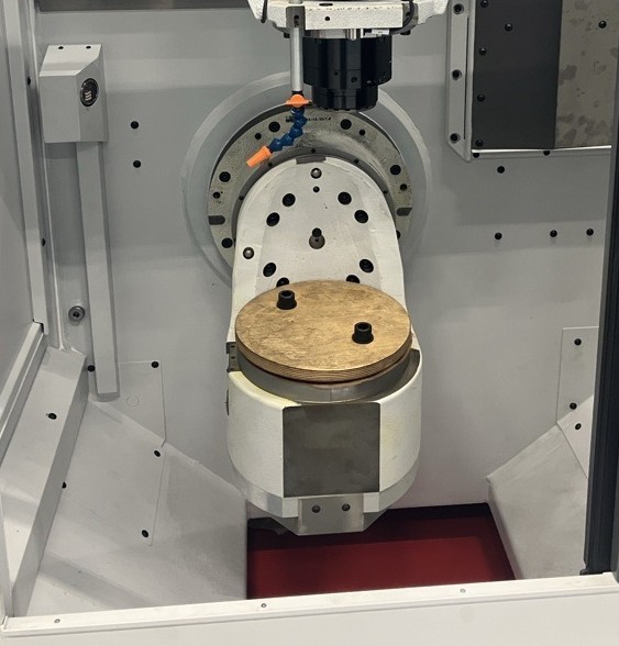

FZ 08 S FX
08 Series
2 months
New machine
12 Months Warranty
FZ 08 S FX
Available at short notice, durable and low-maintenance
Vertical moving column principle
Thermally stable
Highest precision in positioning and simultaneous operation
Dynamic direct drives
Ergonomic operating and loading concept
Service-friendly access to all units
DataLine for machine and process diagnostics can be integrated
All the details at a glance
Technical data
Traverse paths X – Y – Z max.
450 – 270 – 310 mm
Power max.
9.00 kW
Number of spindles
1
Spindle speed max.
30,000 rpm
Chip-to-chip time
2.20 s
Rapid feed X – Y – Z max.
60 – 60 – 60 m/min
Number of tools max.
40
Tool taper
HSK-A40
Workpiece changing device
Table
2 axis rotary table
Control
Fanuc 31iB5
Existing special equipment
  • Probe - package TC 52
