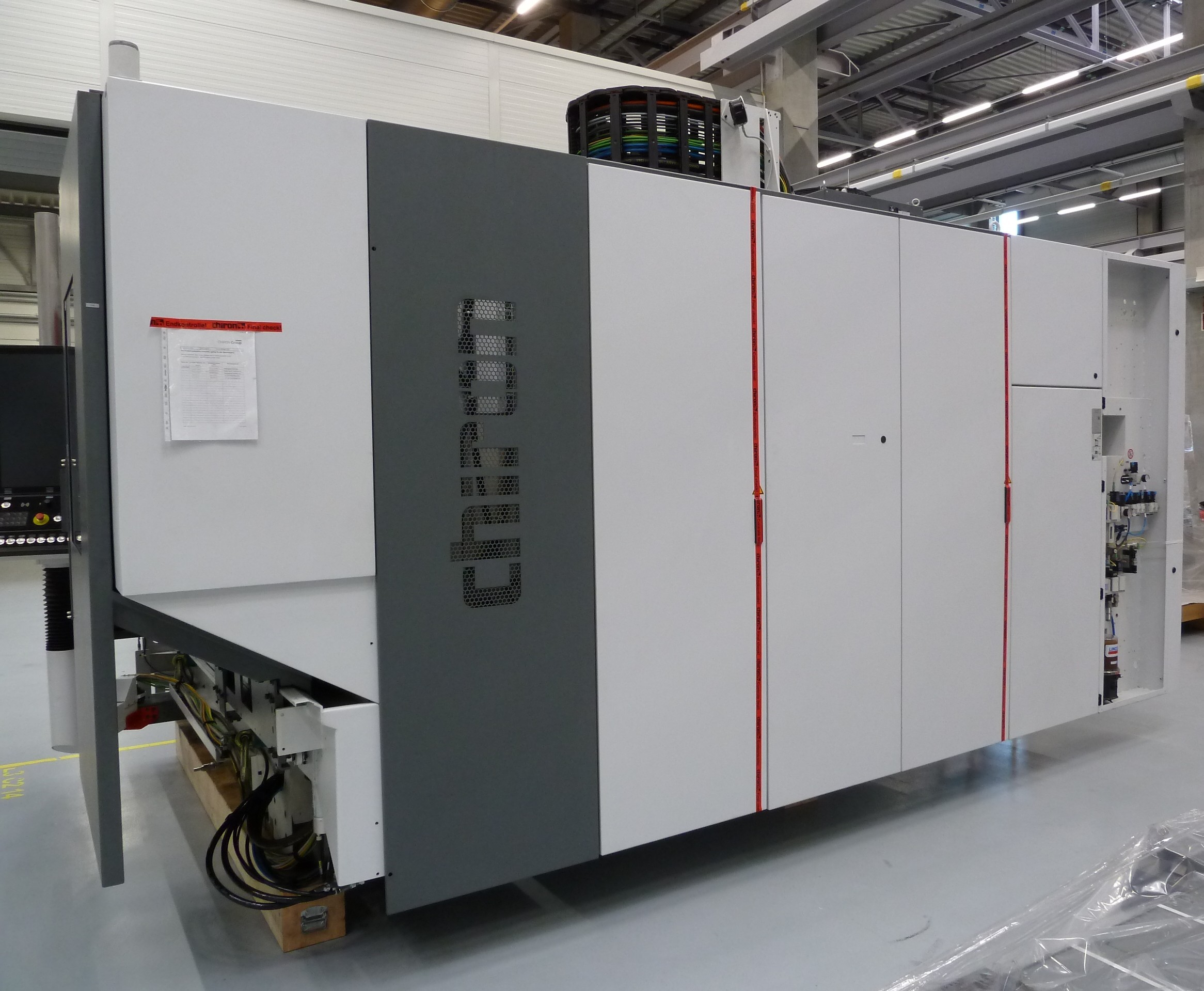

FZ 16 S five axis
16 Series
2 months
Show room machine
6 Months Warranty
The single spindle machine is designed for precise 5-axis machining. Industry-leading dynamics result in a machine that truly shines, ensuring maximum productivity for each application.
In short: Produce more parts, with unrivaled precision
All the details at a glance
Technical data
Traverse paths X – Y – Z max.
660 – 660 – 400 mm
Power max.
50.60 kW
Number of spindles
1
Spindle speed max.
12,500 rpm
Chip-to-chip time
2.90 s
Rapid feed X – Y – Z max.
75 – 75 – 75 m/min
Number of tools max.
162
Tool taper
HSK-A63
Workpiece changing device
Table
2 axis rotary table
Control
Siemens 840D SL
Existing special equipment
  • 5-axis milling package
  • Chip conveyor 1,050 mm
  • CHIRON Kinematics Fit with measuring ball
  • Coolant equipment KF 200 / FKA 700
  • DataLine
  • ConditionLine
  • Exhaust fan 1.100 m³/h
  • Probe - package RMP60Q
  • Automatic loading door
  • Electric interface for loader with Profinet
  • Parts location air sensoring
  • Hydraulic unit
