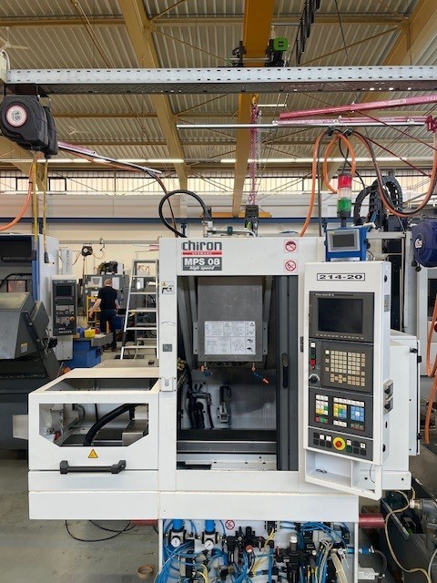

FZ 08 S
08 Series
3 weeks
Partly refurbished machine
3 Months Warranty
MPS 08 S - 214-20
Compact and flexible precision machining center with fixed table and automatic tool change with the pick-up-method. Ample space for devices or NC rotary table installations for multisided machining.
All the details at a glance
Technical data
Traverse paths X – Y – Z max.
300 – 250 – 250 mm
Power max.
3.70 kW
Number of spindles
1
Spindle speed max.
27,000 rpm
Chip-to-chip time
1.50 s
Rapid feed X – Y – Z max.
40 – 40 – 60 m/min
Number of tools max.
12
Tool taper
HSK-A32
Workpiece changing device
CHIRON-basket-tool changer
Table
2 axis rotary table
Clamping surface
620 x 270 mm2
Control
Fanuc 18i
Existing special equipment
  • 2 x NC rotary table
  • Chip conveyor 495 mm
  • Coolant equipment
