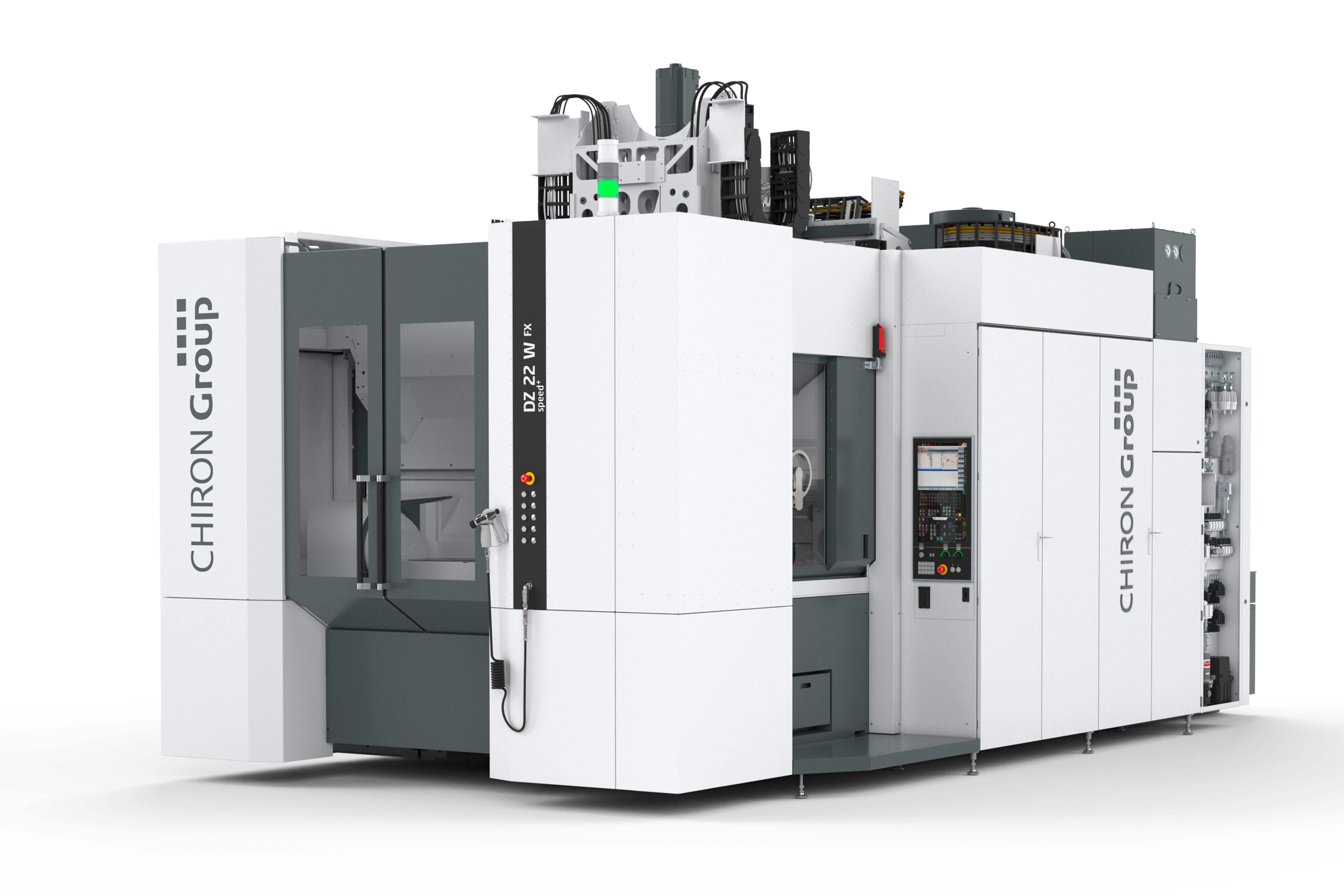

Top speed and top performance in series: the DZ 22 W speed+
With the DZ 22 W speed+, the CHIRON Group is expanding its portfolio with a particularly dynamic version of the double-spindle 5-axis machining center. The new version with 600 mm spindle distance is designed for the economical complete machining of large components in series. With even greater productivity, optimized machine structure and significantly reduced non-productive times.
The performance data: 20 percent higher acceleration and a 40 percent improvement in jerk behavior for significantly faster achievement of maximum speed when changing direction – important for thread cutting, for example. In addition, the core component, the motor spindle developed in-house, has a ramp-up time of 0.5 seconds and a chip-to-chip time of 2.0 seconds. All these factors ensure a significantly faster machining process.
The increased productivity is made possible by targeted design measures. This has made it possible to achieve significantly higher dynamics with the same electrical drive power – without compromising on precision or process stability. “The demands on series production are constantly increasing,” says Senior Product Manager Markus Vollmer. “The DZ 22 W speed+ delivers the decisive plus in process efficiency, noticeably reduces non-productive times and ensures that every second of machining time is optimally utilized.”

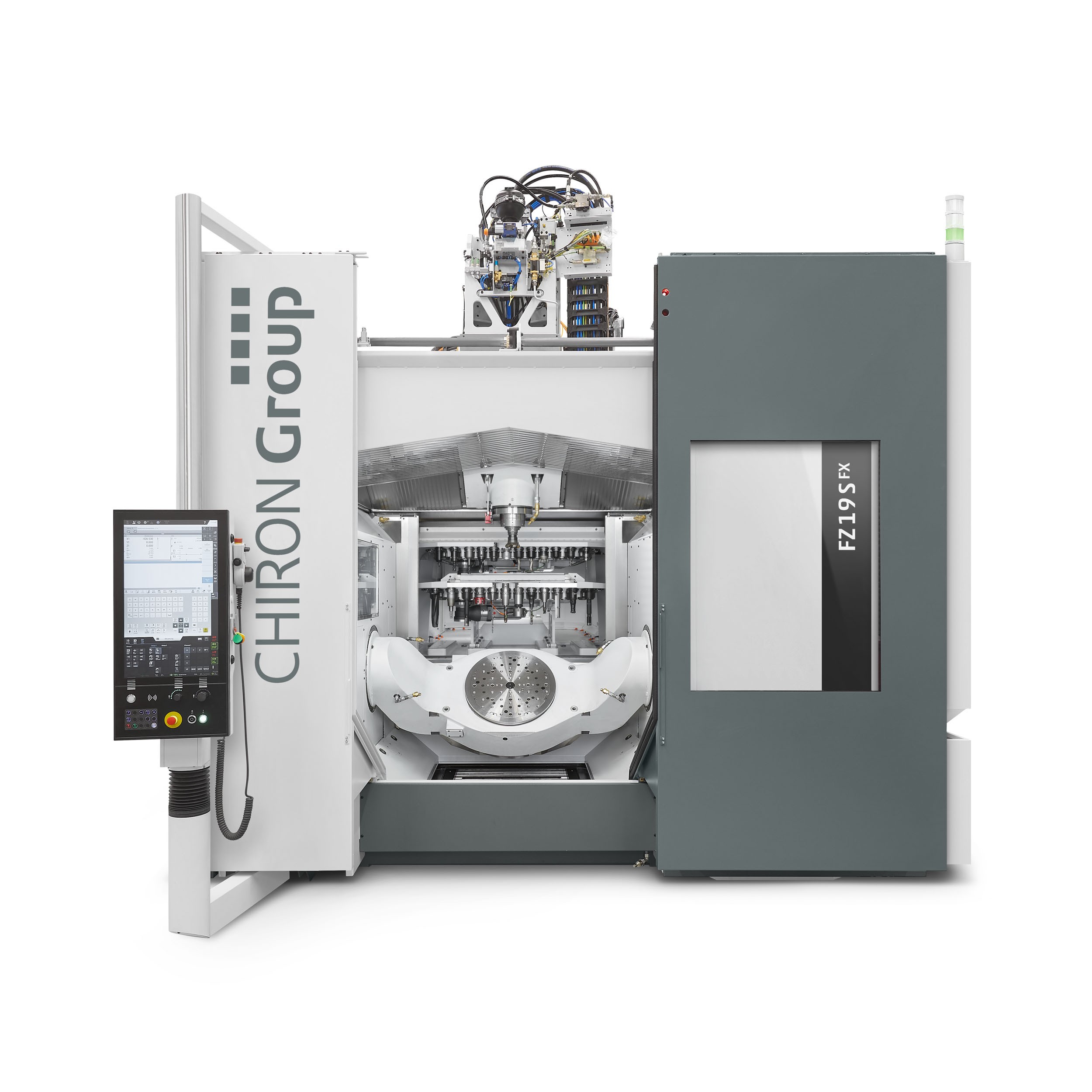

Power, precision, productivity: The FZ 19 S five axis
Trade visitors can see these qualities for themselves at OPEN HOUSE 2025. In live operation, the FZ 19 S five axis produces struts for an aerospace landing gear assembly using precision tools from the cooperation partner MAPAL. For the machining of demanding materials – here titanium grade 5 – the machining center is available with an HSK-A100 interface and a maximum spindle torque of 408 Nm.
Armrests, brackets, engine mounts or airfoils are further examples from the aerospace application field where the machine variant of the Series 19 shows its strengths when machining “from the solid”. The largest magazine for up to 196 tools is recommended for complex components or part variants.
The FZ 19 S five axis impresses with its large traverse paths – 850 mm in X, 960 mm in Y and 700 mm in Z. This makes it ideal for components up to a diameter of 820 mm. In combination with perfectly matched CHIRON Group spindles, this optimum ratio of work area to workpiece dimension enables high-precision and particularly dynamic machining.

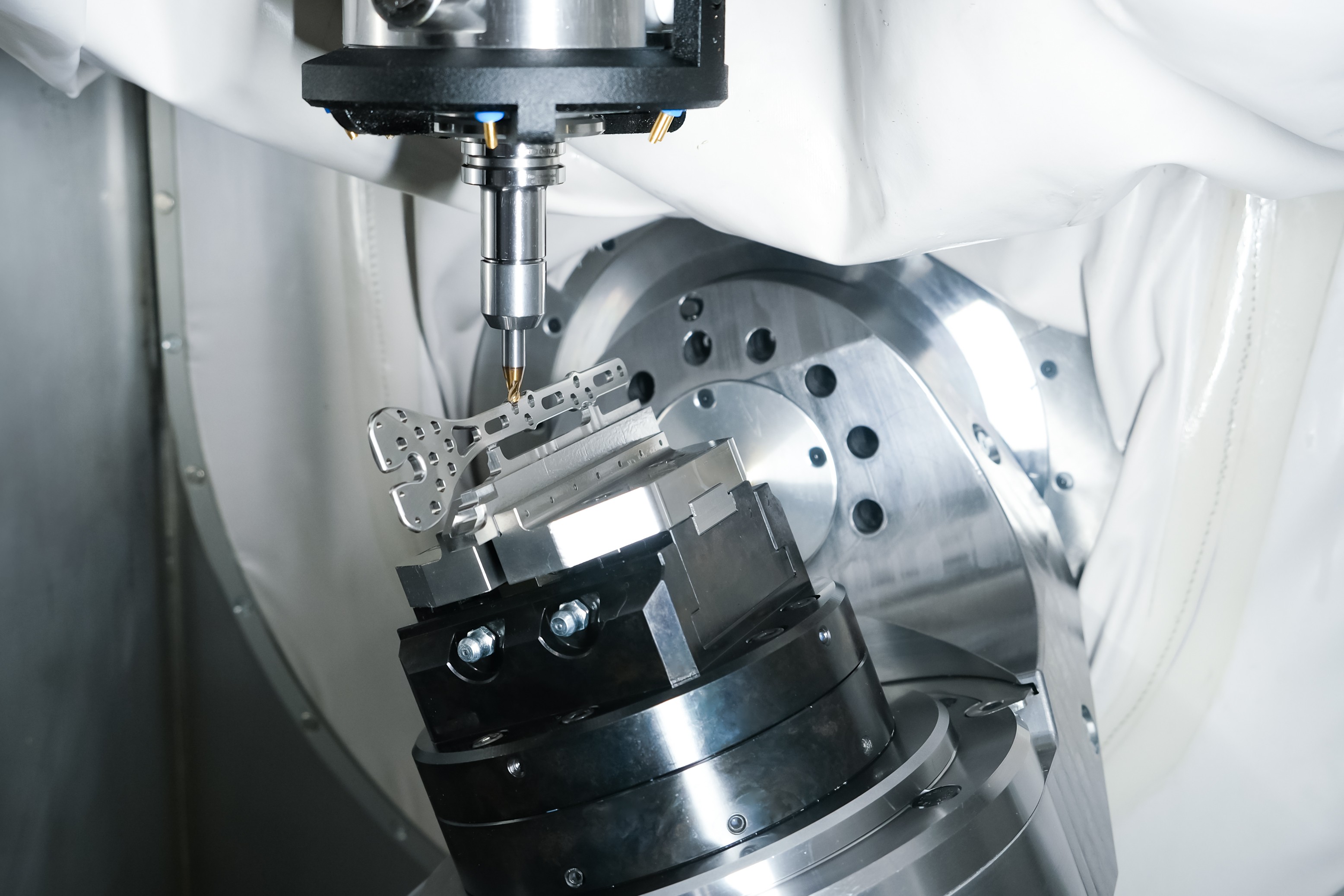

Precision machining of a titanium bone plate – example of the extended range of applications in medical technology with the Micro5 XL.
The new DZ 22 W speed+ for constant top performance and top speed in the complete machining of large components in series.
The FZ 19 S five axis stands for quality and productivity – in series production on a single-spindle machining center.
