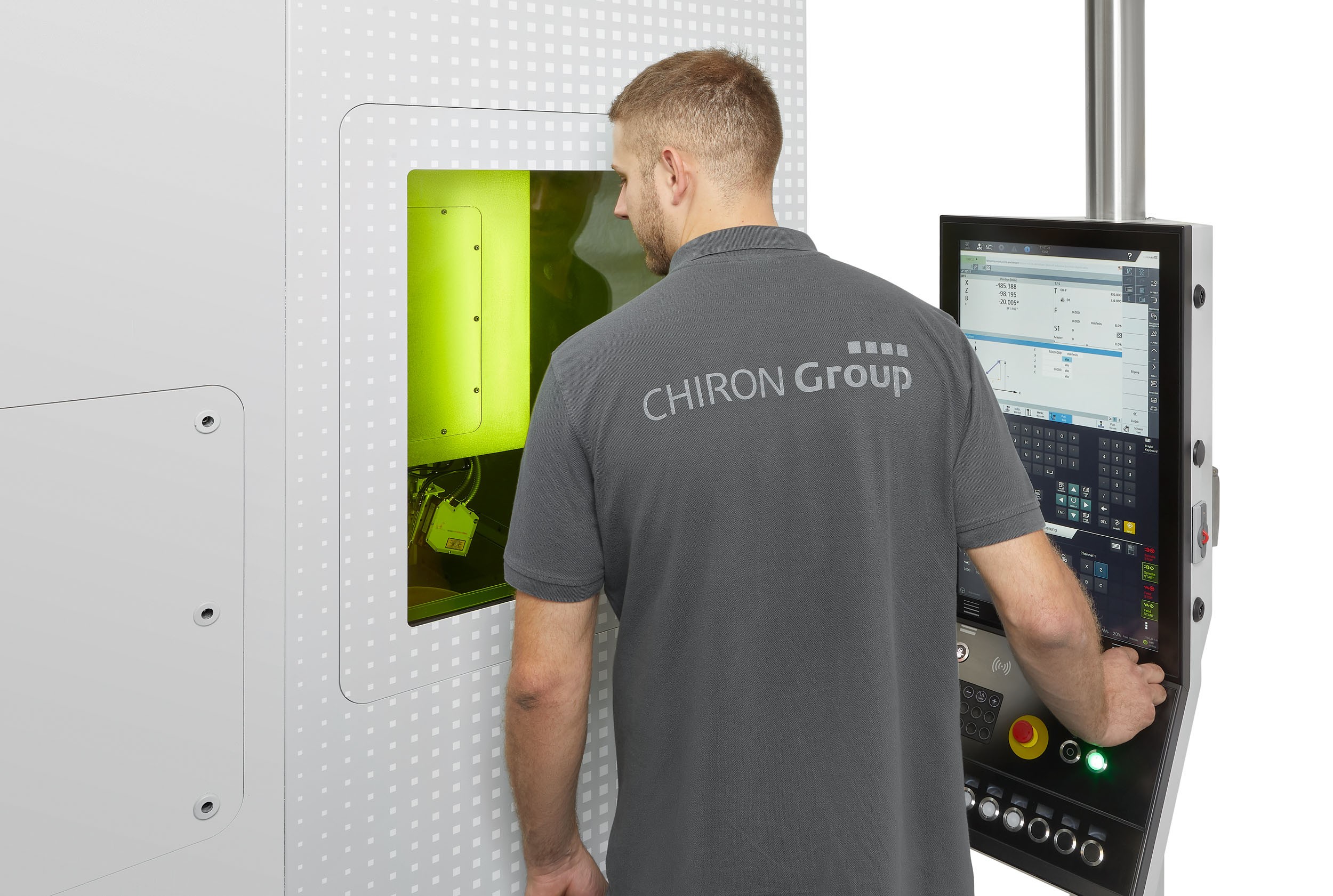

Intuitive operation via TouchLine and the laser protection screen provides an unobstructed view of the process.
